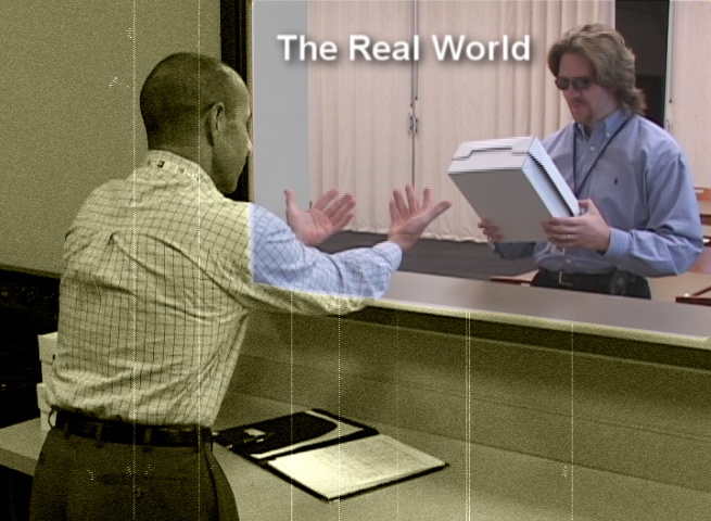

What you can do is create a mask in Photoshop for the thought bubble with a transparent background everywhere and black in the bubble's center.
Import the PSD file into Vegas.
Then you have the following.
Video track 1 Composting Parent Top PS mask set to "cut"
(you could track the mask just make the background around the bubble big enough to move around.)
Video track 2 Composting Child Video of groom
Video track 3 Pictures that show up in thought bubbles.
Here is something I did similar to this, except track 3 was an identical video track and B&W effects are on track 2. Technically there is text media on top, but you get the idea.
Mark Kovalcson is offline   Reply With Quote
