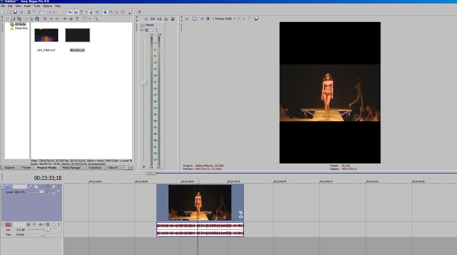

and the final video will only show the middle third with the top and bottom third showing in black? I have attached a pic, does it look like what you mentioned?

Yup, that's exactly what I was talking about. you can now fill in the top and bottom with other media.

is there anyway I can crop and fill the entire vertical screen with just the model walking down the runway?

Not if you want it to look decent, no. It'll be VERY soft and pixelated, and depending on the source, it might even not be recognizable.
