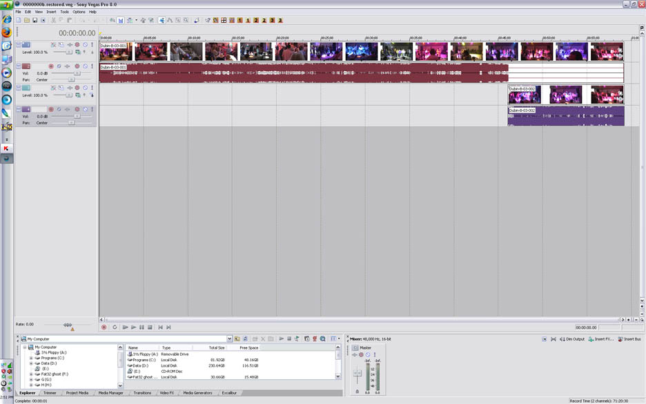

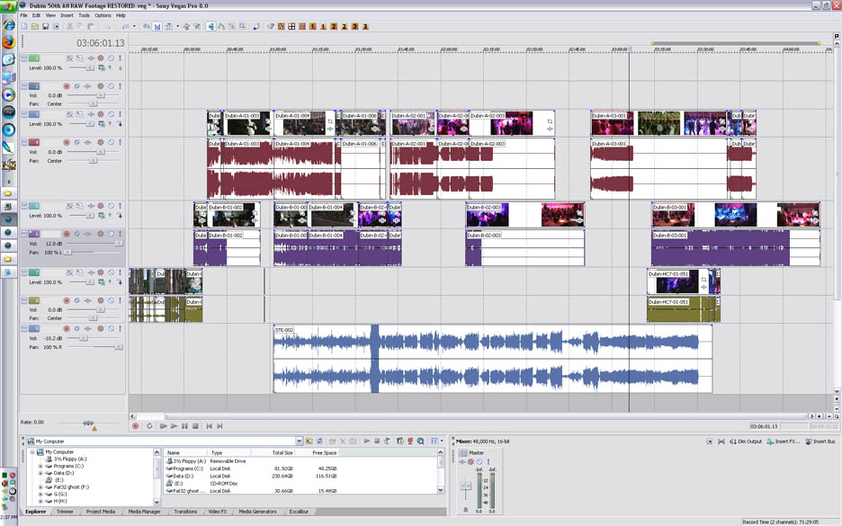

I've been having trouble capturing and working in V8b lately. Maybe someone can shed some light on this.
Here's a screen cap (entitled "vegas audio capture gaps") from V8b showing three HDV tracks. Notice several events have straight line audio. There is audio on the tape, but it was not captured. The top two tracks were shot on HV20s set to 24P, the third track on an HC7, all captured in 60i on the HC7.
The screencap labeled "vegas capture error" shows one track with the straight line audio toward the end, and the track below with the audio captured. So the audio is there, and can be captured, just not all at once. These events were shot with an HV20 in 24P, and captured on an HV20 in HDV mode. This instance of Vegas crashed when I used the mouse wheel to zoom in.
