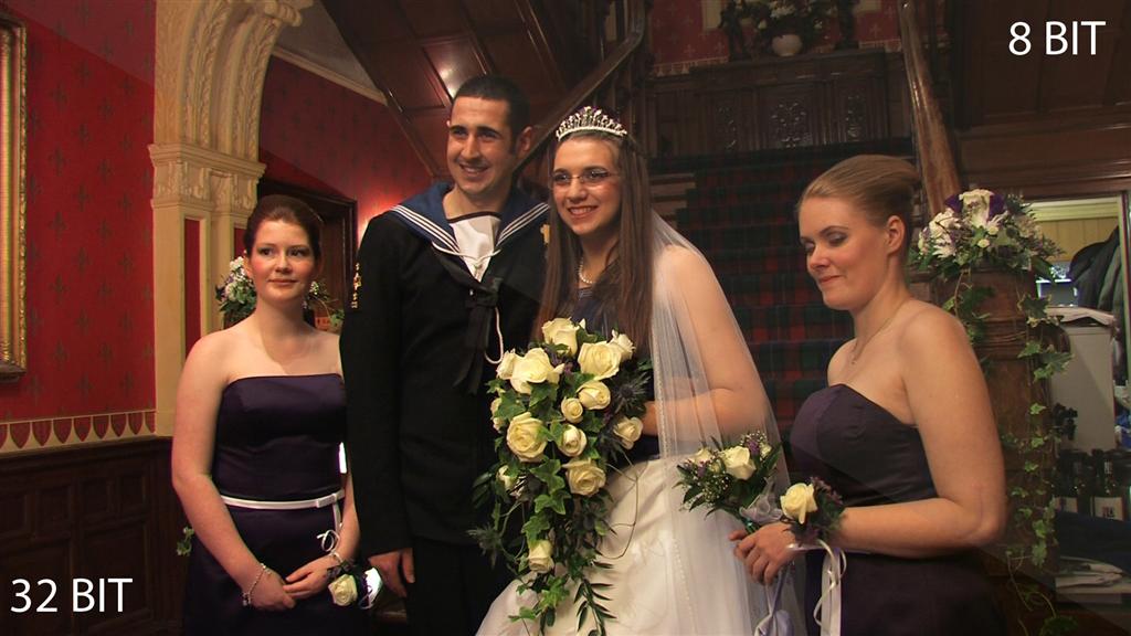

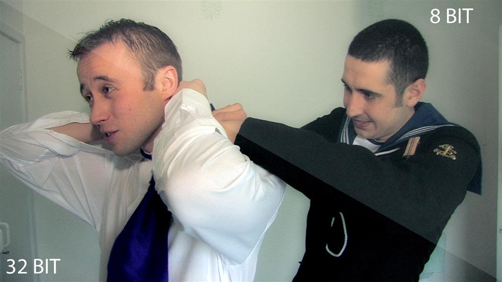

Over simplifying it, 32bit gives you more dynamic range which makes for improved colours (somebody correct me if I am wrong). These pics show the difference. It comes at the price of longer renders.
Magic Bullet Looks-comparison-large-.jpg   Magic Bullet Looks-comparison-2-large-.jpg
