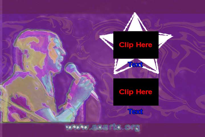

I'm trying to create a "star" mask for a clip when it's highlighted. I've attempted several different ways and what happens is it keeps getting cropped by the media's thumbnail space. I even tried adding a empty button so I could size it bigger in hopes it wouldn't be constrained but yet it still has.
Ideally I would like the mask to spin but I think I'm asking too much, maybe with some scripting I could do it, but I haven't had time to dive into yet.
Here is a shot of the psd in which I'm trying to replicate and a shot of what is actually happening.
dvd-a button/mask help-dvd-menu.jpg

Thanks for the help Graham that's basically what I was doing... I figured it out finally.
At first I was just making the text box large enough to incorporate the mask and just manually getting the text where I wanted it via font size and spaces (<enter>).
Then I realized my problem is I'm using the regular thumbnails for the actual buttons... so instead of doing that I just set the button to be the "empty button" and to basically ignore (never go to) the regular thumnails and it doesn't restrict the highlight then.
So simple in the end but there is certainly not much info out there on such tips... hopefully someone can find this helpfull... if it wasn't clear then let me know and I can go into more detail.
