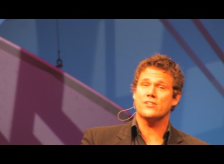

Is there an FX in Vegas Pro 8 that can be used to reduce the glare from stage light?

Without seeing your issue, and as with any clipped/overexposed footage (do we still call it footage when speaking of solid state recording? Intersting .. anyway .. ), once it has gone beyond the limits of recovery we are mostly into the realms of copying and masking in some remedial material to improve matters. However, looking on the bright side (pun there . . ), see if Levels or Colour Corrector or Colour Curves can dampen down the more excessive parts of the "flare". But I'm doubting it will. And somewhat akin to clipped and/or combined audio, separation is often/mostly impossible. Event if you do find a remedy, you will need to apply it on a localised way - you don;t want it effecting the whole frame - and this calls for further management of the the way you apply the Fx/s. So, copying tracks and masking and allowing them to interact will have to be considered too.
If you are unable to live WITH it then make a FEATURE from it? If possible? Add some GlowFx or exaggerate it with RaysFx. You never know, you may just add some reality that provides an alternative to your search for removal?

Thanks! I tried using levels and the color colors, but those didn't help. I suspect I'll be living with it as is.

Could you post a still, Stephen?

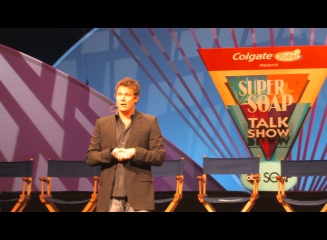

[QUOTE=Ian Stark;998333]Could you post a still, Stephen?[/QUOTE
I've attached a couple to this reply.
Thanks for attaching the screenshot. I imported it into my Vegas and tried the color corrector adding more blue to Mid and high and then added secondary corrector adding more blue-green and came up with this. Still far from perfect but if you like it I can send you the numbers I tried and see if it looks any better on playback...
http://i121.photobucket.com/albums/o...y_thoughts.jpg
Good luck
Good luck
If you don't mind sending me the numbers I would like to try them on playback. Thanks!

Sorry about the delay my daughter is sick
...and I had to get her settled. ok here are the numbers i tried.
Color corrector (3 wheel)
Low - Mid - High
0.0 - 341.6 - 347.1 Angle
0.0 - 0.196 - .5 Magnitude
Sat - 1 Gain - 1
Gam - 1 Offset -9.5
Color corrector secondary
Angle 264.8 magnitude 0.177
Rotate hue - 0.0
Sat - 1.0
Gamma - .948
Gain 1.0
Offset 0.0
Alpha 1.0
Limit Sat
low 0.0
high 147.5
smooth 0.0
Limit hue
center 178.2
width 360
smooth 0
limit luminance
low 0.0
high 255.0
smooth 0.0
That's what i used. Good luck, i hope it helps.

I was thinking about using the secondary color corrector to isolate the colors on the face and tone them back down.
How do you isolate the colors on the face?
As Ken said, you would use the secondary color corrector. Then you'll use the eyedropper to pick the face color range. You can then make adjustments to just that color range. NOTE: if the same color exists in the background (i.e. wall color, some other item of a similar color in the background) that would be affected as well.
I have an article you may be interested in in one of my newsletters where the secondary color corrector is used to let a single color show through with the rest of the image black and white. The concepts in that article would get you pointed in the right direction. Look for the issue with "Color Pass - Reprised".

Also after you use the eyedropper you can select the "Show mask" option and the areas that show as white are the areas affected by your selection. Sometimes there are subtleties that the software detects that you can't see with your naked eye.
