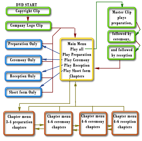

I have a newbie question for you. I am using DVDA and want to create a menu based DVD. I want to create a wedding DVD where when you put the DVD in to play it. The menu pops up and gives you options as to what you want to view. Such as: Play the entire DVD, Cake Cutting, First Dance, The Toast...ect... Here is my question. Do I have to render each part by it's self, then put it into DVDA? or can I render the entire wedding and have thoses parts in the menu? And if I do have to render each part by it's self, is there a way to view the entire wedding. Like having one of the parts say "Play entire wedding" I have read over the manual and just don't understand how to do this.
Any help would be great

The short answer is yes, render as one piece of video. Then, import the clip into DVDA, and create chapters that point to the various pieces of the long clip that you want available individually. This is the most straightforward method.
The user will see the wedding clip starting from the chapter they selected through to the end.
The DVD specification is very flexible, and so is DVDA, so, it is possible to create this experience with individual clips through the use of "end actions", in which you specify what happens when a clip completes, eg. go to menu, go to sub menu, go to start of next clip, etc. But this is painstaking work for no gain, when the big-clip-with-chapters method works so well for what you want.
For a step-by-step, please see Edward Troxel's excellent newsletters. I believe the DVDA chapters tutorials were written for an earlier version, but this part hasn't changed much.

Mike,
I follow a similar workflow but have often wanted to create a DVD that behaves differently. I am going to layout a wedding-type scenario and see what you guys think.
Assets
1 - long movie with many chapter points for each major event and many sub-sections with AC3 audio.
1 - main menu
4 chapter selection pages.
I have attached the graphic to clarify the behavior I would like to see. At this time the only way I have found to make this behavior work is to place the main video clip on the DVD twice. Once as a solid piece for the play all and chapter options and once broken into 4 clips to play each one isolated. This is really inefficient use of disc space so I am wondering if there is a better way. What do you guys think? Is there another way?
