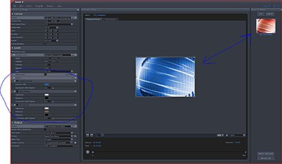

here's a screen shot of some re-coloring options in Juicer 3 used on Jump Back 05 Sports. I would be surprised if it weren't an option for the volume you have as well. :-)
The original colored image is top right. The recolored image is center on the "desk top".

Mike, I just installed the latest update to check if there were a difference in versions. I still have the same options for that Jumpback. I'd hope the same tweaks were universally available across their product line, but i guess it's possible they're not. The volume does have to be installed in order to have the adjustablility options available.
Ed, can you choose a specific color to tweak with secondary color corrector? I messed with it and only achieved an overall, universal change. Not like exclusively changing red to blue, and leaving other colors untouched. Juicer doesn't do that either, i don't think, but i hopefully read that into your response re: Vegas' color corrector.
Juicer does allow up to tri color tweaks, with low mid and highlights adjustable.

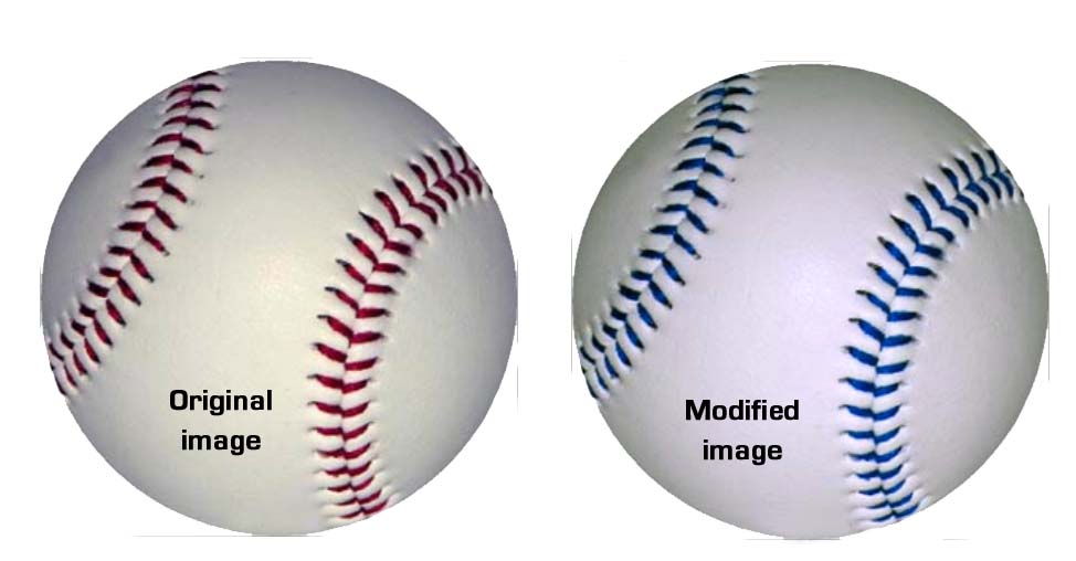

I'm obviously not Edward but, after some experimenting, I can answer this question.
Follow the steps outlined in "Doing A Color Pass ", the first article in Vol #1, Issue #11 of his newsletters.
Once you complete the steps in the article, add another Secondary Color Corrector to the clip on track 1 and adjust the hue to the desired color.
As you can see, it works like a charm :-)

Thanks alot Mike <Ed, lol>.
Masks and compositing modes have always been a tough subject for me.
I got it to work and match your result, but only with alot of blind trial and error, without fully understanding what i was doing. Still, the ability to create a color mask with secondary color corrector was new for me, so thanks alot!
Changing the compositing mode on track 1 to multiply mask seems to be an unspoken necessity i think i noticed.
It was adding the secondary color corrector to track 3 that got me the blue threads.
Thanks for all :-).
