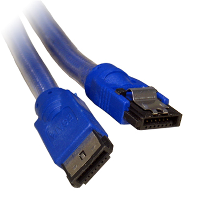

I was wary of this as well, but was able to cut at least half the risk out, by buying a E-sata to Sata cable and then threading the cables into my case and directly onto the sata slots of my motherboard. My case has little rubber gromits where water-cooling tubes can be inserted, but they're perfect for the cables.
Still no solution. I think this is the best solution so far. The lead i showed on the very first post is actually what you need for this setup SATA with spring lock at one side, and eSATA with precious little locking at the other end. So...at least one end will be held firm inside the pc and retained somewhat by the grommits. All you have to rely on for the eSATA side are the tiny spring blips shown in the attached picture.
Best I can offer is to (with the cable unplugged!) carefully tease these out just a little, so that you have a fraction more tension to hold the plug in situ.
Alternatively, make a little L bracket up from a piece of right angled plastic and put some heavy duty double side tape on it to then stick/hold/brace the cable in place.
Anyone else found anything else?
