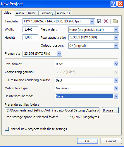

I believe my settings are correct. Here thy are:
It's not that I don't care at all what's causing it, It's just that I would just like to get through this by manually adjusting the clip (like I can do in other NLE's). I do ultimately want to know what is causing it. I'm rendering back to m2t to put back in my other NLE.

I'm sorry, Marcle, but as you said your settings do look correct.
