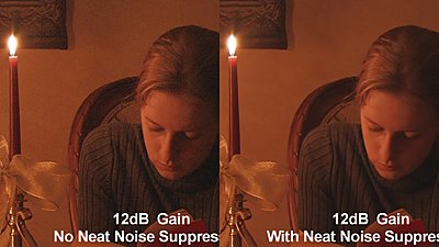

I broke down and purchased Neat Video's Pro noise suppression to use with Vegas Pro 8 after reading a thread earlier in the week on DVInfo. I love my XHA1, but it's low light performance is not stellar and it has a little more noise in some situations that the best cameras. Look at these candlelight tests with the XHA1 at +12 dB gain.
These are my first attempts with the software, and there are infinite combinations for adjusting filters and detail sharpening. I'm very impressed thus far and it only gets better from here!
Wow!! Neat Video Noise Suppression for Vegas!!-neat-noise-supp-candlelight.jpg

Roger, I agree Neat Video is amazing. Are you using the sharpening as well? It works great because it does not sharpen the noise since it knows what the noise is in the clip.
I also use Neat video for After Effects and when using it in 16 bit mode you can get even better quality.

Thanks for taking the time to share, Roger. Impressive.

I am a fan of Neat as well. It can also be used as an interesting artistic effect. I used it in this way on the title sequence and specific segments of a documentary I made last year. I applied very extreme settings which really softened the image up nicely without blurring.
