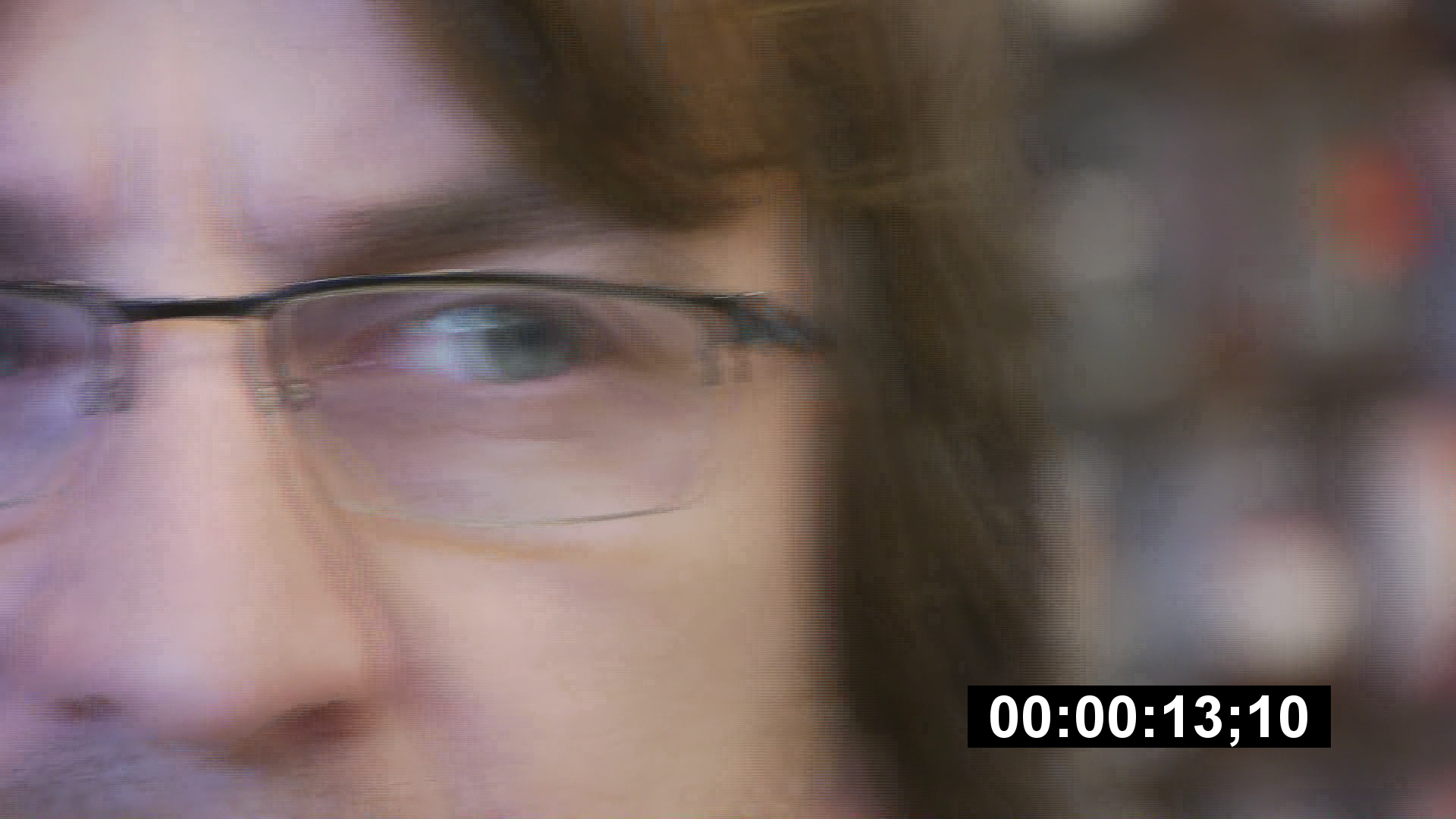

I think I'm having de-interlacing problems. I'm not sure what to do about it, here's a still frame (PNG)

Also by transcoding from AVCHD to another HD format you still have the problem that the file is still interlaced video with Upper Field first and if you are going to DVD then you need lower field first ..this means you have to de-interlace first!!!
Donald...that's probably your problem!! In your project properties, you need to put the de-interlace setting to "Interpolate" and change the Render Quality to best ...that's what often causes the quality drop.

after watching a rendered clip I still have the exact same de-interlacing problem.

I didn't know that so in your case you need to leave the de-interlace setting as "NONE"
When you render, Vegas will by default interlace it unless you tell it not to!! If you are watching it only on your 'puter or making an online video then render as progressive in you custom render settings. You will get interlacing lines if you watch the clip on your computer but a TV will handle the interlacing lines normally.

When I watch my ruff footage (after being converted from MTS to MPG files) when I pause it I can see the de-interlacing problem is already there, before I even import them for editing. can this be fixed in some way?
I sent a question to the makers of the HD converting program, to know if their program does only interlaced footage or progressive also.
I also tried what you told, setting the de-interlacing method to NONE and it dosent change anything.

It sounds like the conversion is messing around with the interlacing which can happen if you are downsizing. However it seems like to are producing the same size clip ???
I know that in UpShift you have an option to leave the interlacing as it is or transcode as progressive. If you are sure that you did in fact shoot progressive then there is no reason that the transcoding software should add interlacing unless it tells you to!! Most, by default, will leave the footage alone. In UpShift you can definately leave the interlaced setting as "copy from input" which means if you have progressive footage, it will stay progressive!! If the new HD file is progressive then Vegas doesn't have to have any de-interlace settings at all.
It might be an idea to make sure that you have the correct project properties by clicking the folder icon in Project properties and opening one file and let Vegas choose the correct template???

The problem is obviously the conversion, I downloaded the trial version of Cineform Neo Scene, The first test I did seems to fix the de-interlacing problem, so the first conclusion : Do not download "Free AVCHD Converter" for your MTS files, it dosent work properly and dosent have the Frame rate option.
