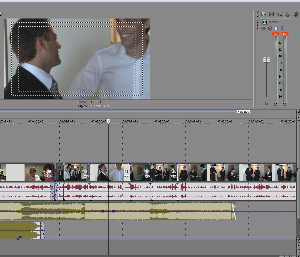

when I apply volume envelope to turn music audio volume down suddenly it becomes like test tone of high frequency and on volume meter is shown like 350+ db. what is going on?

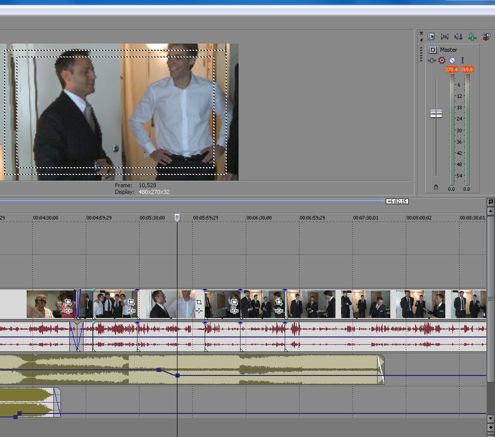

I place music audio file below track with video footage and when I add point in volume line to lower music down it goes to beep of extremal volume AS SOON AS is pases that added point on volume line ( see audio Master reading).
Audio behaving very strange-vegasaudio1.jpg   Audio behaving very strange-vegasaudio2.jpg

I am not "cutting" anything I am lowering SLIGHTLY volume of background music to hear narration; Interesting - when I reopen that project and reload that music audio file and do nothing, audio will become beep in very same spot like in last project. Is this like "memory effect"?
I had to move the music audio file to different audio track to play it normal.

What are the media properties of the audio file that is having the problems?
From the attached screenshot, what you have layed out should behave normally.
