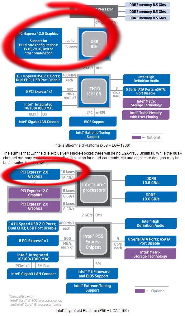

Old November 8th, 2009, 10:16 AM   #26
Posts: 1,832
Jeff,
Can you explain these architectural differences in relation to ASUS claim?
Old November 8th, 2009, 10:59 AM   #27
Location: Cincinnati, OH
Posts: 8,425
Nope, I don't understand it.
Old November 8th, 2009, 11:44 AM   #28
Posts: 1,832
Vito, I will get back to your very valid questions, but first to the architecture of the P55 versus the X58.
The X58 has 36 PCI-e lanes, that can be configured as the mobo manufacturers want. So you have for instance one PCI-e 16x, two PCI-e 8x and a single PCI-e 4x slot or you can have 2 PCI-e 16x slots and a single PCI-e 4x slot, all amounting to 36 lanes.
Usually you will have one PCI-e slot for a video card at PCI-e 16x, leaving you with only 20 lanes for expansion. That is quite enough for a PCI-e 8x raid controller or other cards, even a second PCI-e 16x video card in SLI configuration and an additional PCI-e 4x raid controller.
The P55 has only 16 lanes. These can be used in a single slot or in a dual PCI-e 8x slot configuration. Now, if you want to have the same video capability as an X58, all your lanes are used. There may be additional physical slots on the mobo, but the chipset does not have any more lanes available, unless you downgrade the video card from 16x to 8x.
So here is the major drawback of the P55. And Vito, you are correct, I mistakenly mentioned integrated graphics, that is plain wrong (Westmere does that), but the bottom line is that if you want to use a 16x PCI-e card for video, all your lanes are used up and you have no more expansion capability, due to the ingetrated PCI-e bus. My bad.
Sorry.
The P55 does allow 2 video cards in SLI configuration, but only as dual PCI-e 8x cards, which means a performance penalty hit. It still does not allow a raid controller to be added, due to the lack of available lanes on the chip.
Old November 8th, 2009, 03:45 PM   #29
Posts: 8,425
Harm, I installed and ran host raid controllers (Adaptec 1225 and 1430) on my LGA 775 board almost 2 years ago for over a year (and still run them on my current board). They are 4x (maybe less, I don't remember) I believe and transfer files at about 100 to 150 Mbps drive depending on the drive.
Why wouldn't they run on a board that is two years newer and fairly feature rich? I don't understand why 1366 boards cannot run raid controllers.
What am I missing here? I don't know much about computers, but this is especially confusing to me.
Old November 8th, 2009, 04:49 PM   #30
Posts: 1,832
Jeff,
I use an Areca ARC-1680iX-12, which is a PCI-e 8x board with the IOP 348 chip and it gives me an average transfer rate of 853 MB/s.
These kind of boards can ONLY run on X58 boards, not on P55 boards due to the lack of PCI lanes.
Harm Millaard is offline   Reply
