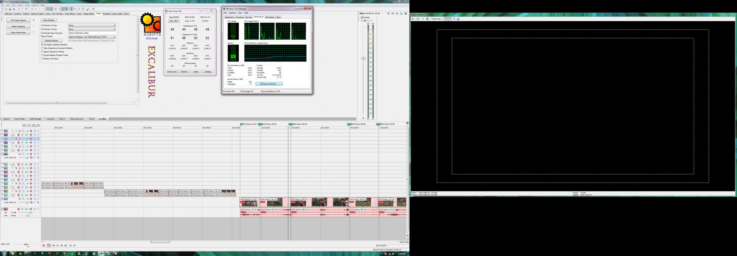

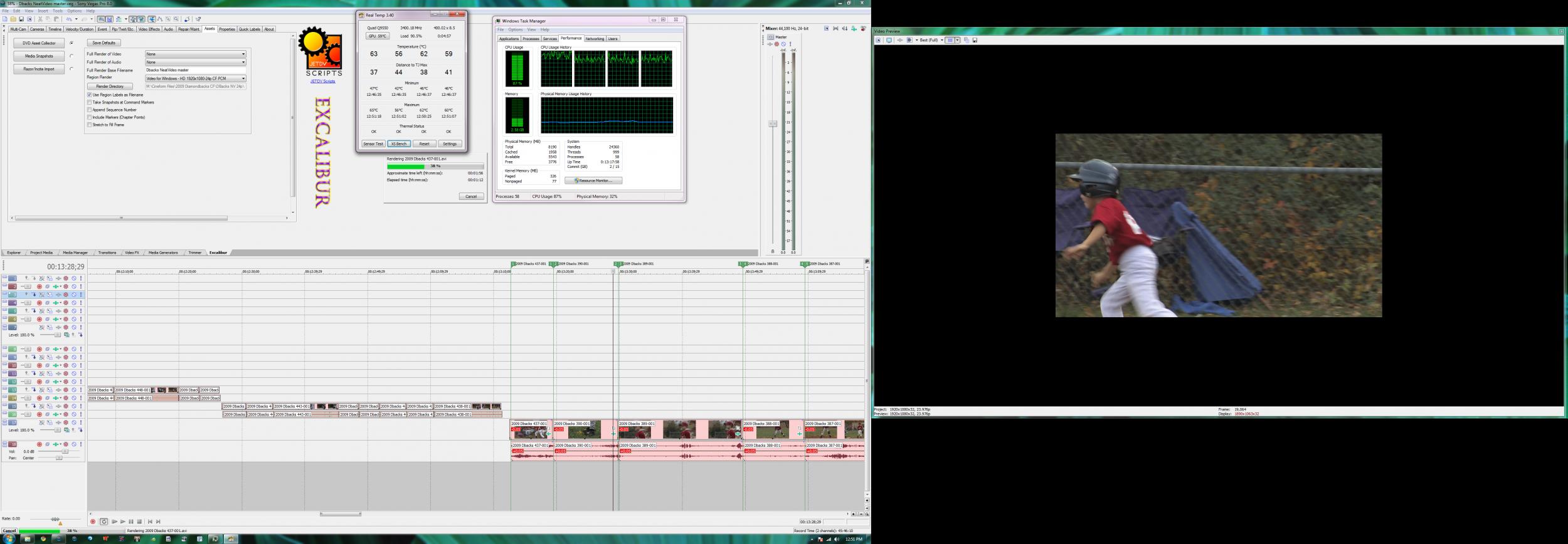

Temps were my very first suspect, Edward. As you can see in the screen shots below, before render (idle) CPU is essentially 0%, temps are in the 40's. During render, CPU is around 80% and temps are never more than 65*C. I can also run the Intel Burn Test until the cows come home and have no problems. To me, therefore, these parameters are fine, so I don't think I have a hardware problem.
It looks like I have Vegas and/or NeatVideo gremlins wholly separate from Excalibur. I'm open to any other suggestions, but I'm afraid that my woes have gone too astray from the OP's question to keep this alive here.
