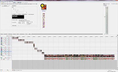

Old November 14th, 2009, 08:07 AM   #15
Location: Salem, Oregon
Posts: 435
Not so automated after all :(
I thought I would post back after playing a few days with Excalibur. I think it's just great. What isn't great is what I had hoped would be just an overnight render, courtesy of Excalibur, has turned into a nightmare of repeated cycles of Vegas 8.0c crashing.
My screen grab below shows how I've had to baby sit my project: define regions, hit "DVD Asset Collector," begin render, Vegas crashes after about 5-10 clips, restart Vegas, move rest of project A/V to new tracks, delete old regions and define new regions for remaining project (so as to avoid defining regions that have already rendered), lather, rinse, and repeat. Argh! This was supposed to be easy and instead I'm losing sleep.
I don't think my troubles have anything to do with Excalibur. I'm running 8.0c on a freshly installed Windows 7 x64 system. I have 8GB of RAM and Task Manager indicates that Vegas is not even approaching a memory limit during renders. 8.1 was a total nightmare, despite what memory advantages it may offer, so I'm not even going there. I wonder if the trouble resides with NeatVideo, which is a known resource hog. But still, on a screaming system?
I realize my problem is OT for this thread, but if someone has any ideas, I'd sure welcome them.
