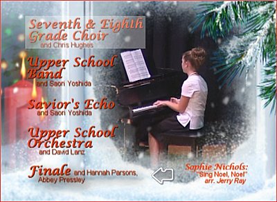

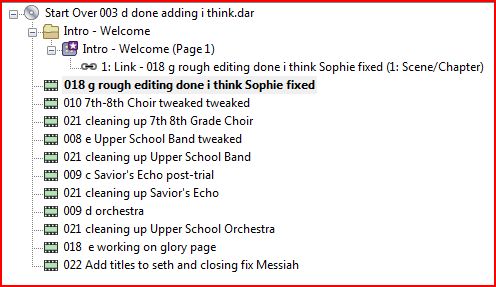

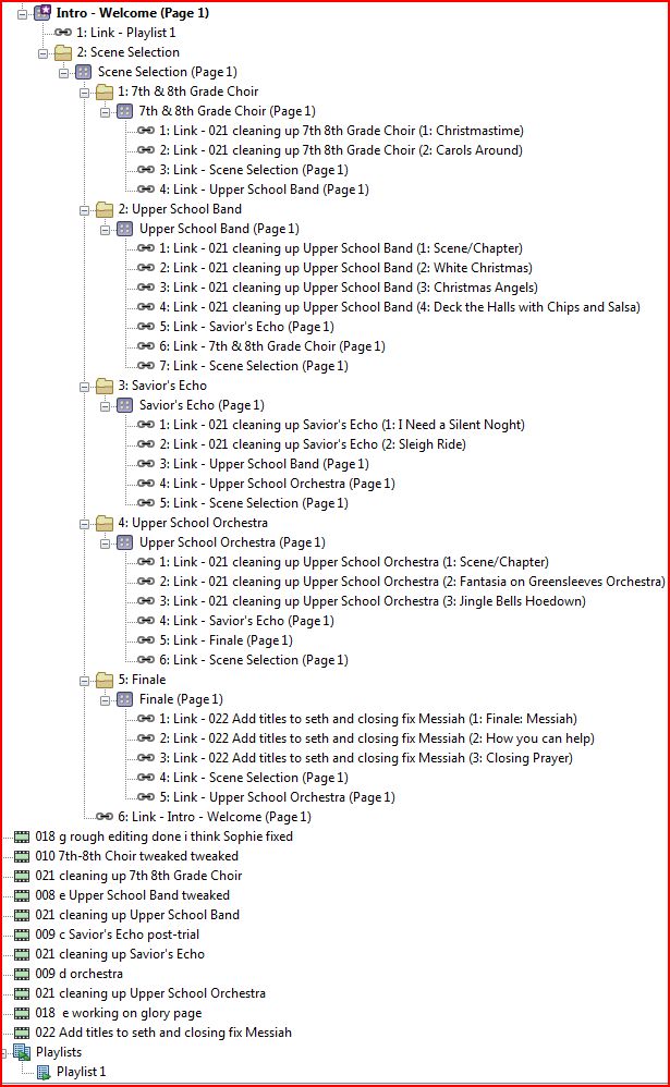

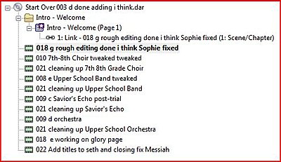

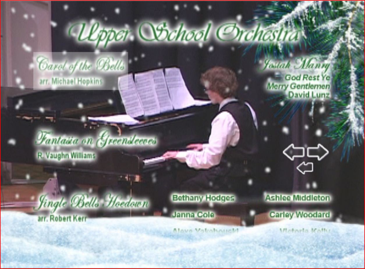

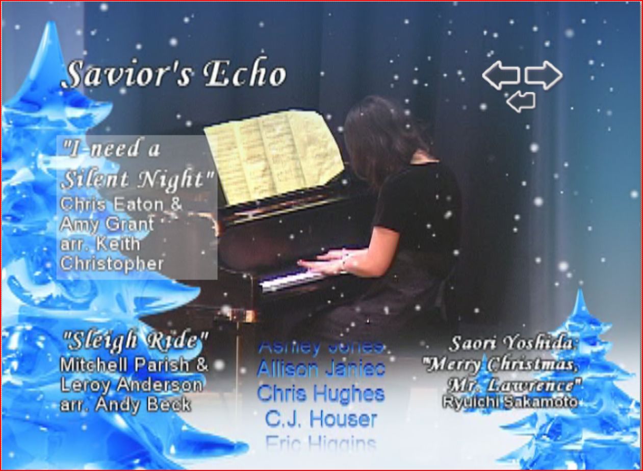

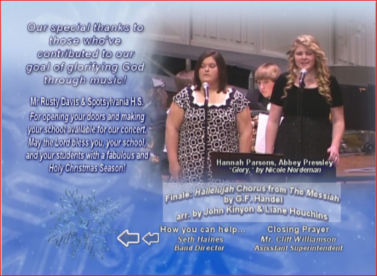

i guess i could do a screen shot...
this compares the 2 structures i tried; whew!

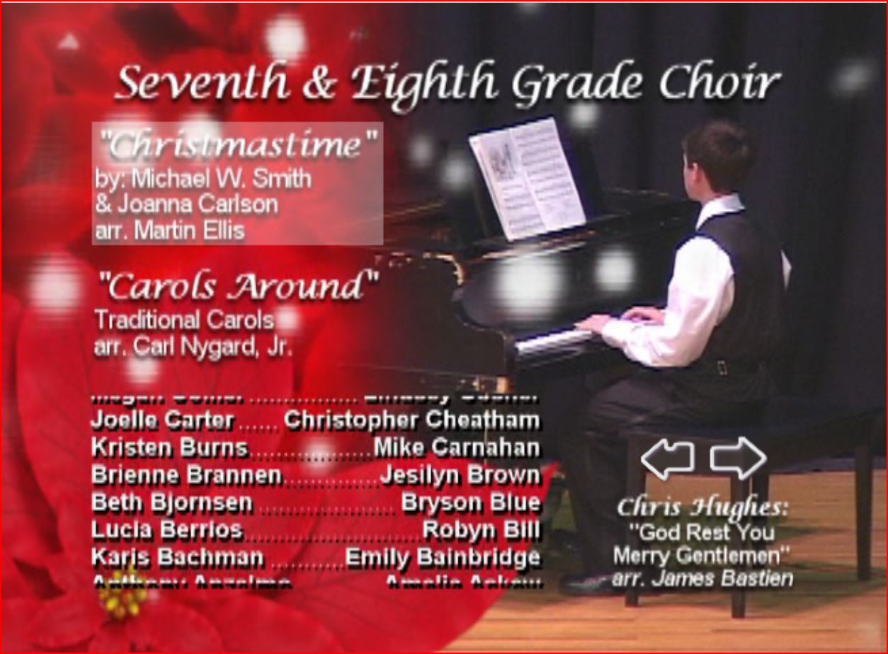

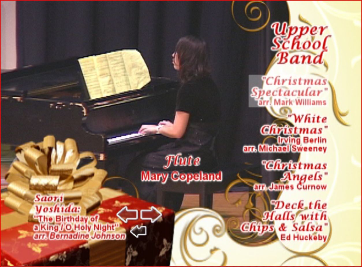

and screen shots of the soloists performances seconding as menus
The actual class performances will play between the soloists, if not specifically selected by the user ahead of time.
I guess one of my goals was to include the soloists in standard sequential play, while also spotlighting them in menus. I wanted to spotlight them without potentially isolating them from normal viewing. I also think it spices up the "menu."
DVDArch5:  Loss of Menu Selection after FF in Menu-screen-shot.jpg   DVDArch5:  Loss of Menu Selection after FF in Menu-screen-shot-old.jpg
DVDArch5:  Loss of Menu Selection after FF in Menu-soloist-1.jpg   DVDArch5:  Loss of Menu Selection after FF in Menu-soloist-2.jpg
DVDArch5:  Loss of Menu Selection after FF in Menu-soloist-3.jpg   DVDArch5:  Loss of Menu Selection after FF in Menu-soloist-4.jpg
DVDArch5:  Loss of Menu Selection after FF in Menu-soloist-5.jpg   DVDArch5:  Loss of Menu Selection after FF in Menu-soloist-6.jpg

Thank you for reminding me to check the obvious, which i didn't. Having done it now, i observed tht DVD player #2 does not FF at all in the "menus," but still will in the standard clips of the class performances. When i play the DVD in my desktop comp. via Windows Media Player, the button highlight disappears after jumping forward on the progress bar, but i can still subsequently access any of the buttons by clicking on them with the mouse. As a matter of fact, just moving the mouse over one of the buttons re-highlights it. So.... once the highlight is gone on DVD player #1, i have lost the navigability with the remote. If there were some way to restore/ensure some button would be selected, awaiting activation upon coming out of FF. I guess i'm asking too much.

All right fellas, forgive me for asking you to consider the issue in a different light. So far a large amount of focus has been given to the problem in the context of a menu, as I originally intentionally painted it in that light because that's how I was using the button feature.
Allow me to widen the issue/conversation, because what I'm really just doing is "Adding Buttons to Video," as it's listed in the DVDA help files. If we ignore the menu aspect of my particular scenario... anyone trying to Add Buttons to Video will experience this "glitch" (in my world it's a glitch), where a Button Added To Video will lose its selectability if the video is fast forwarded once inside the "button region."
This seems to be an inappropriate side affect.
Any ideas/interest in this light?
