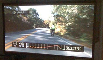

I am using Vegas Pro 9 and would like to create an elapse timer and graphics similar to this Virtual Bicycling Video. Does anyone know a good program or plug in that can do this? Thanks!

Create a blank Sony Text title, set the length in it's properties to how long the timer is supposed to run, then use a Media FX and use the built-in "Sony Timecode" plugin.
After the plug-in is enabled, if you want, you can set the Timecode format to "Time" to get a timer that goes to thousandths of a second. (0.000 sec) Otherwise it's just the frame numbers.
There is also positioning to help position it right on the edge of the title safe.
That's the timer portion. Now just make the rest in Photoshop and do clever beizer masking to make it seem animated.
If you want some of the numbers on the left to be random, and actually achieve more accuracy to what is in that photo, Sony Vegas and Photoshop alone won't help. You'll have to add After Effects into the mix.
