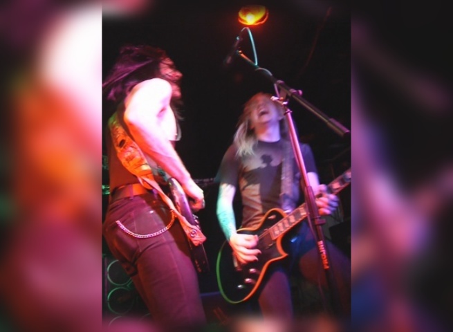

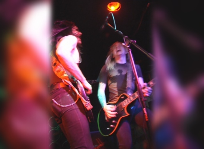

What a lot of folks are doing in similar situations (me included), is to place the footage or still on a lower track, add Gaussian blur to it and then place the same footage or still on the upper track.
A blurred border (or anything else) can be added to the rotated footage/still to help it blend in better.
edit: feel free to use anything image-related for the lower track as you're limited only by your imagination and creativity.
