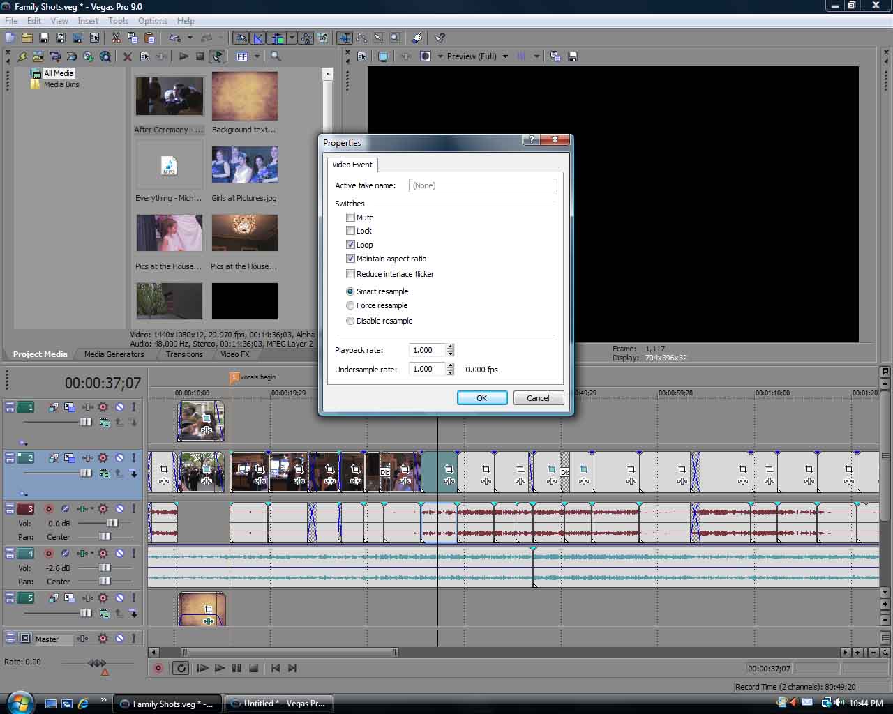

Can't take this. Everytime I do a project with Vegas something goes crazy with the file wasting hours of work.
Here's a project I'm working on - a wedding video. This is a small portion of it. Take a look at the picture I've attached. Vegas has all the project media listed but the timeline shows empty squares. As you can see, I've placed my cursor in the timeline and the preview screen is dark - as if there isn't any media there.
I checked the project file and it correctly shows the last time it was modified and saved so I didn't accidentally make crazy changes and save it later on. I just re-opened the file to do some work and voila. EDIT: So I tried to copy and paste the entire project into a new project to see if I could make changes there. In the new project, the Project Media section is missing a whole lot of files. I find this odd since in the original, f'd up project all the media is listed in that Project Media section. Seriously. I want to unleash a string a profanities in and smash my monitor but I'm pretty sure that wouldn't help anything.
Also, a couple of scenes that are showing up are the wrong media even though right-clicking the event to see its properties (the files they should be calling to) appears to be correct. You know what, don't even worry about this last thing. Whatever. I've dealt with it so many times I don't even care anymore.
If you have any advice about the blanks on the timeline, please help. That's all I can say. Using 64-bit Vista. Yay.

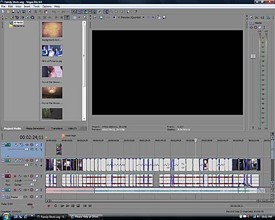

Jim,
Here's another shot. I'm not sure, but it sounds like you're asking if the video event that is controlled by Track Motion is showing up. It is.
BTW, the two video scenes you see in the Vegas Preview screen - outside the church after the ceremony - shouldn't be there. And the video file they are from isn't even showing up in the Project Media section.

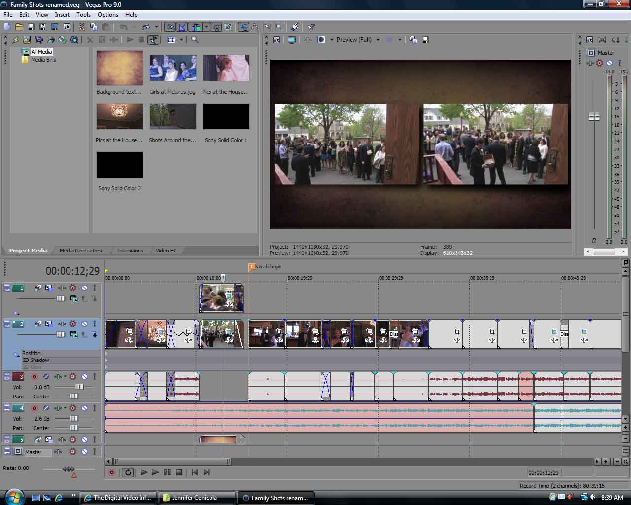

I got a message that the file was corrupted and could not be opened. But I haven't updated to 9.0e yet if that makes a difference.
