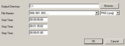

Edward, the script has a Step Time option as well as Start and Stop time settings to allow you to customize it.
In the screenshot shown, I set it to render a frame once every second.

It's been ages since I used that script so I didn't remember exactly what options were available.
