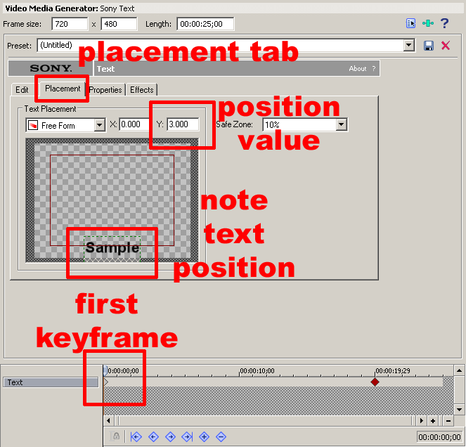

Roy, there's no need to use Premiere Pro to do this.
I use Vegas Pro but the following technique can be done in VMS without a Velocity envelope and here's how.
Use the Default text Media Generator (it has an alpha channel so the text will show up over top of video), not the credit roll one.
Make sure that this goes on a track on top of your video event.
This is preferable as you can add a drop shadow and change various other attributes, sometimes on a line by line basis.
Enter in all the text as desired.
Don't worry about it going off the bottom as we'll deal with that in a moment.

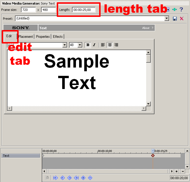

Set the desired length in the very first tab.
In this example, I'll use 20 seconds.
Make sure to set the length to 25 seconds for reasons that will become apparent shortly.
Once all the text is entered, switch to the Placement tab.
Enter a (positive) value in the X box so that the text just disappears off the bottom of the screen.
This assumes that you want it to do a slow reveal going up.

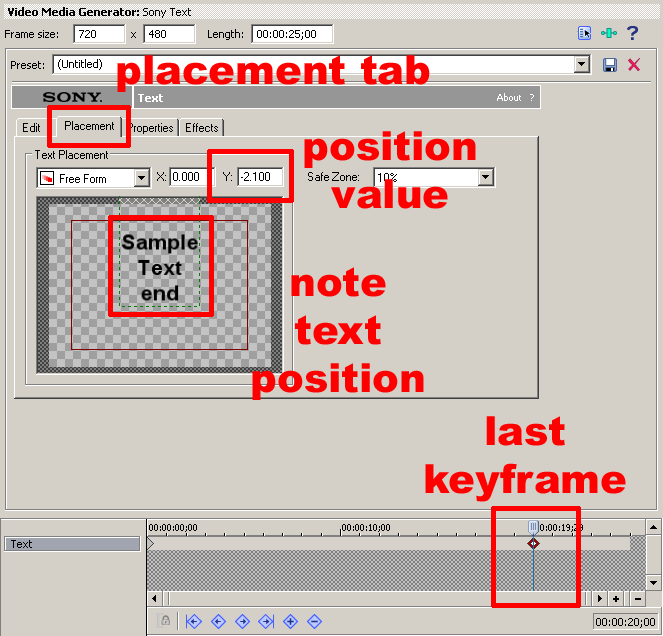

Go to the 20 second mark on the timeline and create a keyframe there.
Right-click it and select "Hold".
In the Y box, enter a new (negative) value so that the text is now in the centre of the screen.
Exit Generated Media, stretch the event to 25 seconds and play it to see if it's to your satisfaction.
If not, adjust accordingly.
The reason for the "Hold" keyframe and the extra 5 seconds is to allow you to have the text remaining on the screen once the roll is done.
Feel free to extend this length as desired.
Note that you can't stretch the event out past this point as the roll will start to repeat itself.
Please let me know if any of this doesn't make sense to you.

Roy, hopefully the attached images will help.
Credit roll with vms 10hd platinum-credits-1.png   Credit roll with vms 10hd platinum-credits-2.png
