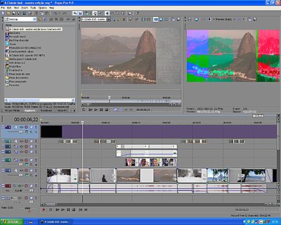

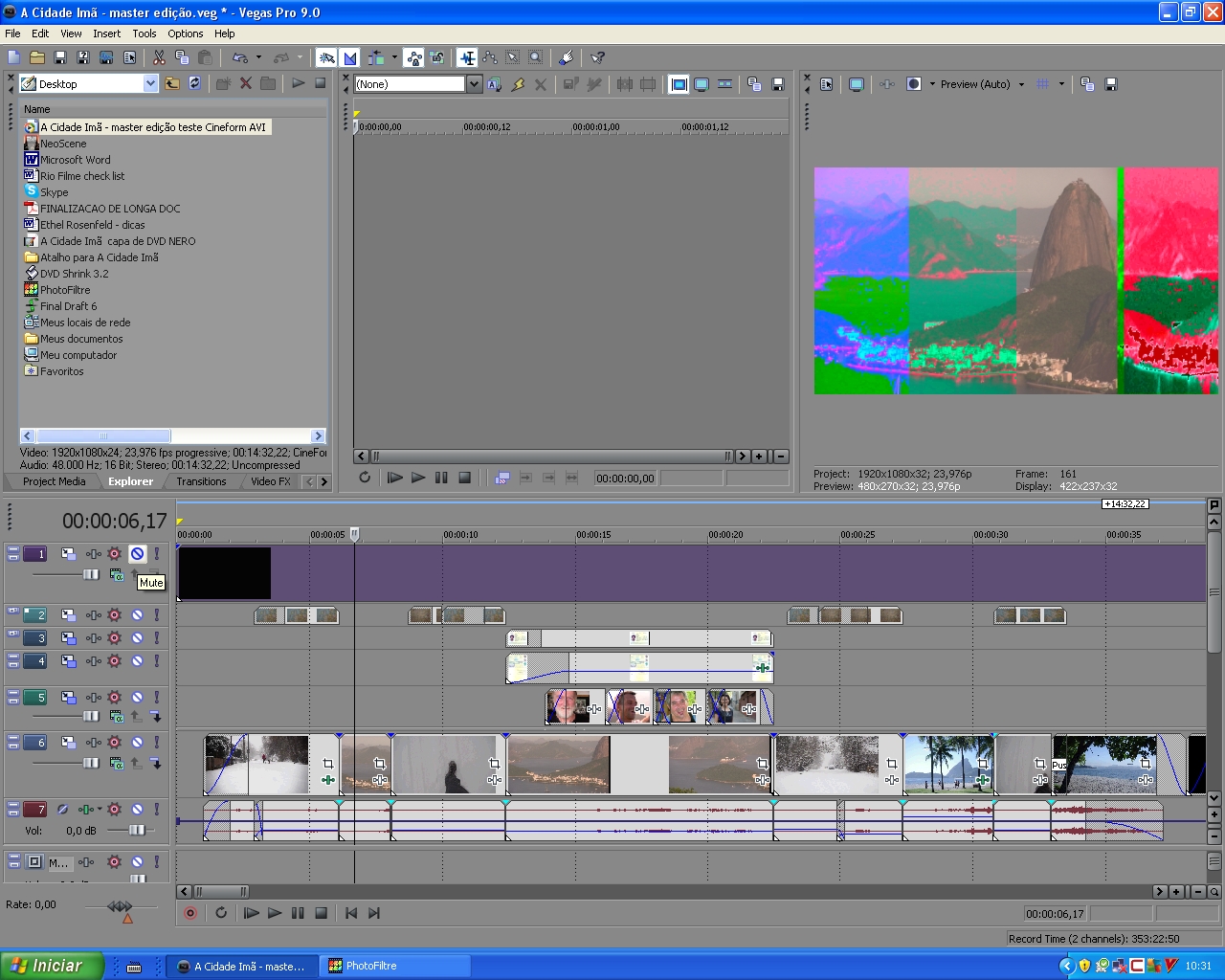

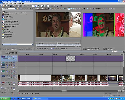

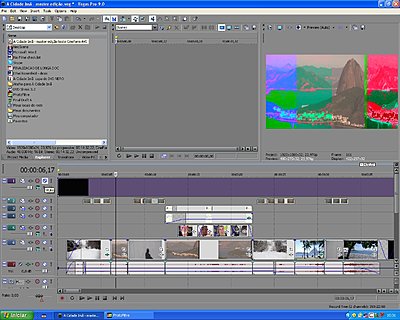

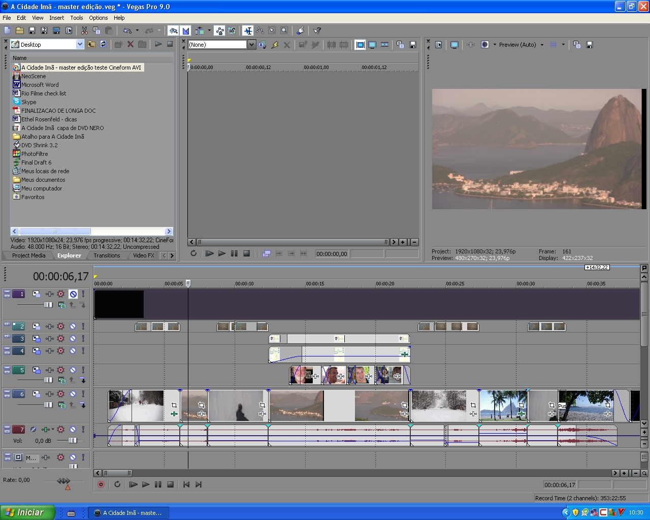

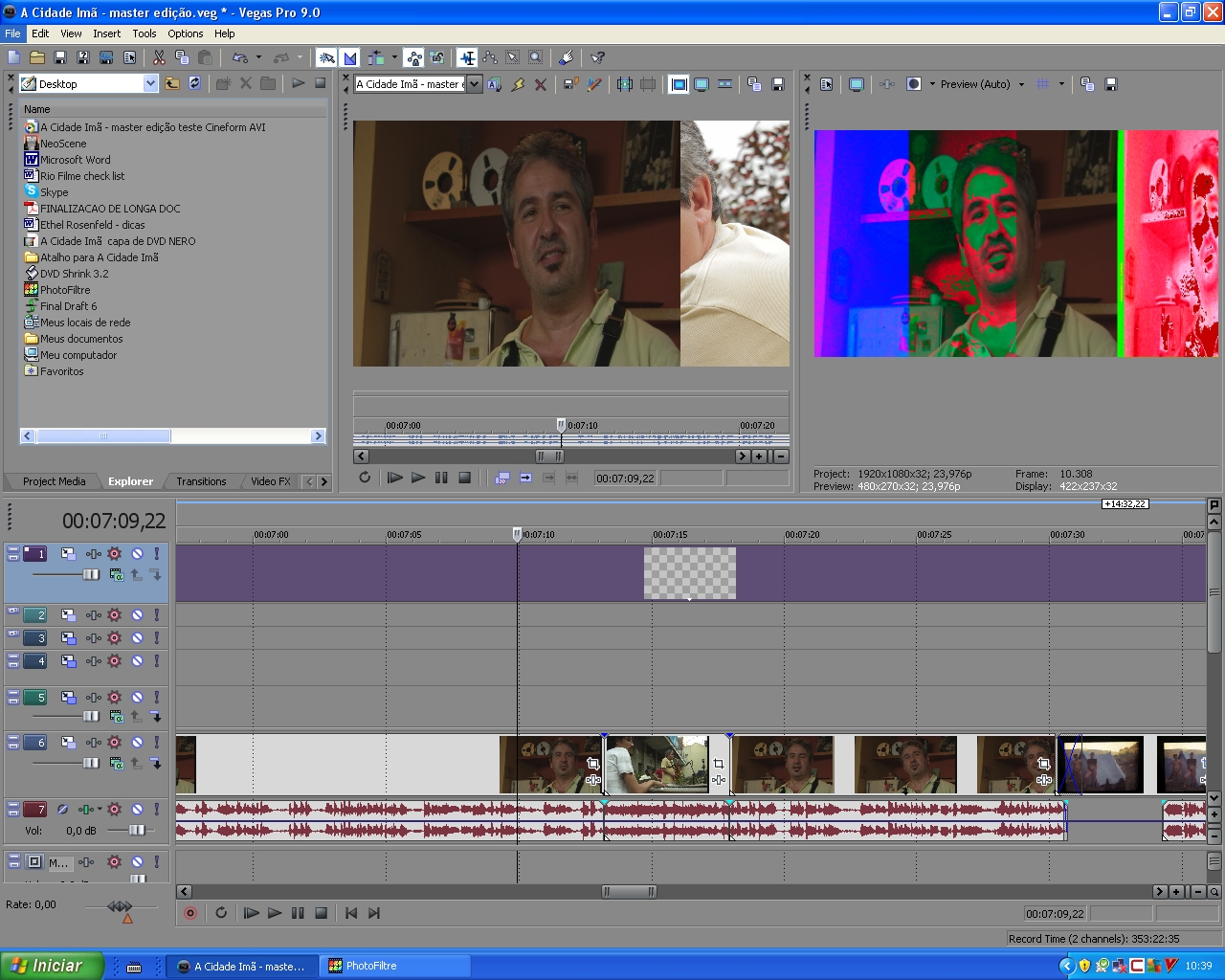

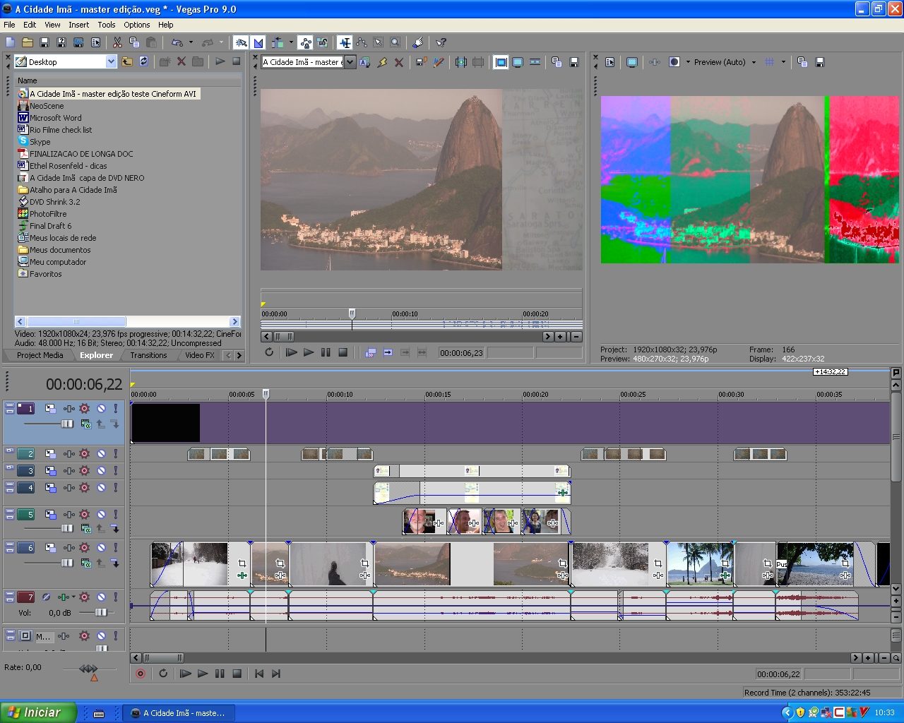

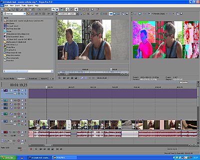

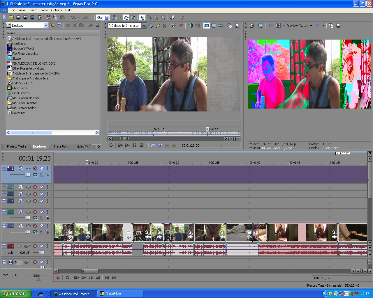

Besides the MXF rendering problem, I did a deeper checking in the rendered to HD 1080-24p, Sony YUV codec, to Cineform HD Codec, version 6.9.0 file and noticed that the problems are exclusively with the Neoscene files of the project!
So I made some print screens that possibly clear (to someone) whats happening.
In my Vegas 9.0e 32 bits, I inserted the rendered AVI (Cineform HD Codec, version 6.9.0) file exactly above the project tracks to get (the same) correspondent frames.
There are 3 screen 1`s:
one with the rendered track mute, when you see only the preview (rec) window and the project video tracks.
The second is with rendered track on, when you see the "special effect" in the same frame in the rendered file.
In the third screen 1 I included the rendered file in trimmer window, so you can see that, for the same image in the same file you get diferent "special effects" introduced, you see that one third of the frame in trimmer window shows part of a frame of a clip of a anterior sequence!
I made more two screens, 2 and 3, that shows the same issuein other parts of the project.
So, for now, I can`t render my project to the full HD files that interest me.
New technology mystery, Vegas 9.0e-screen-1-rendered-mute.jpg   New technology mystery, Vegas 9.0e-screen-1-rendered-.jpg
New technology mystery, Vegas 9.0e-screen-1-rendered-trimmer.jpg   New technology mystery, Vegas 9.0e-screen-2-rendered-trimmer.jpg
