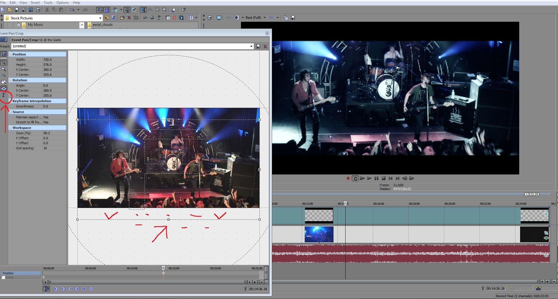

See the attached pic, you can do exactly what you want to do very easily.

Thats exactly what im doing :) , for each clip individualy. W/o the Pic, right now, but i defenetely see where it will become a lot more handy latter on.
I gues i have to bouncy shots for ur method to give me a great benefit. Other than that, i do go Pan/crop for each clip and adjust the height of 781 and then adjust the position on Y axis with keyframes. :)
