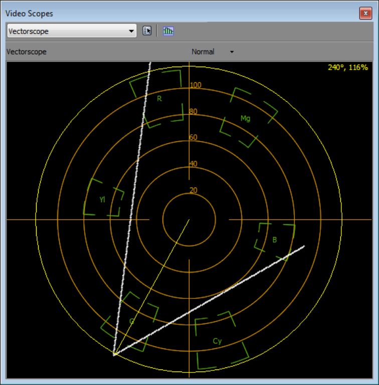

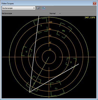

If you look at the Sony Vegas vectorscope and move the cursor over it, a yellow line connects your cursor position with the center of the vectorscope (see the enclosed image, though unfortunately it does not show the cursor itself, but in this case I held the cursor at the point where the two withe lines connect).
In the upper right corner, an angle is shown. In the enclosed example, the angle is 240°. That is the hue of any color that would lie anywhere on the yellow line seen in the example. As you can see, the yellow line crosses the letter G, which stands for green. So, the hue of any green pixel, from dark green to light green is 240°.
When used in effects, such as the "add hue" example above, Sony Vegas expresses this angle in values from 0.00 to 1.00. If you multiply that value by 360, you will convert it to degrees (Vegas, and many other editors, uses the values from 0 to 1 instead of 0 to 360 because it is more intuitive, especially for people who are not aware of hue being the angle on the color wheel). So, if you "add" 0.5 hue, Vegas will rotate the hue of every pixel by 0.5 * 360° = 180° (or, if you prefer, it turns the entire color wheel by 180°). That is a particularly interesting effect as all colors look like the "negative" but without the change in luminosity that exists in a true film negative. In an actual negative, light green turns into dark magenta. In the rotation by 180° light green turns into light magenta instead, as neither its luminosity (brightness, from dark to light) nor its saturation (color vs. black and white) is affected. In other words, the color of each pixel becomes its complementary color.
If you add 1.00 instead, Vegas will rotate the wheel by 1.00 * 360° = 360°, which means nothing will change (since turning a wheel by 360° just brings it back to its original position).
I hope this explains it. If not, keep asking. ;)
