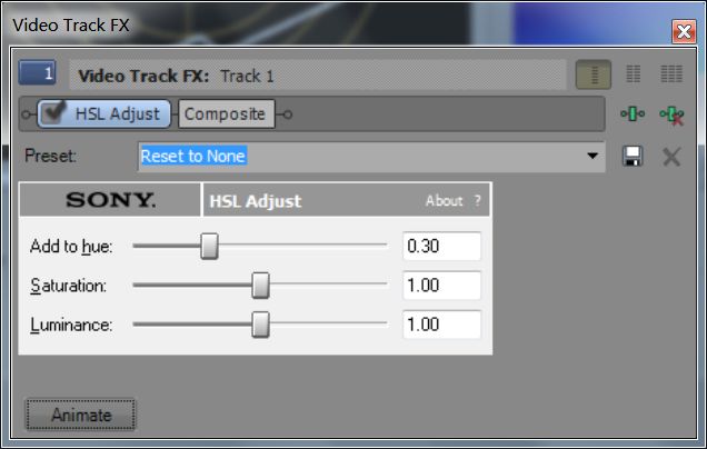

Richard, the 256 values (steps) you're referring to are levels of luminance, not hue.
0-0-0 to 1-1-1 is one step, 1-1-1- to 2-2-2 is another step, all the way to 255-255-255.
On the other hand, colour (not hue) has 16,777,216 values/steps (256 x 256 x 256).
0-0-0 to 0-0-1 is one step, 0-0-1 to 0-0-2 is another step, all the way to 255-255-255.
That still doesn't sound right to me but I can't think of a better way to say it.

Here is the hue adjusting effect from Sony Vegas. It treats hue as a floating point value between 0.00 and 1.00. That seemingly only offers 101 values, but you can type in a more precise value (e.g. 0.123456).
Hue is actually an angle on the color wheel. It determines what color a pixel has regardless of its luminosity or saturation. That is, its value, while numeric, represents things such as red, green, orange, etc.
