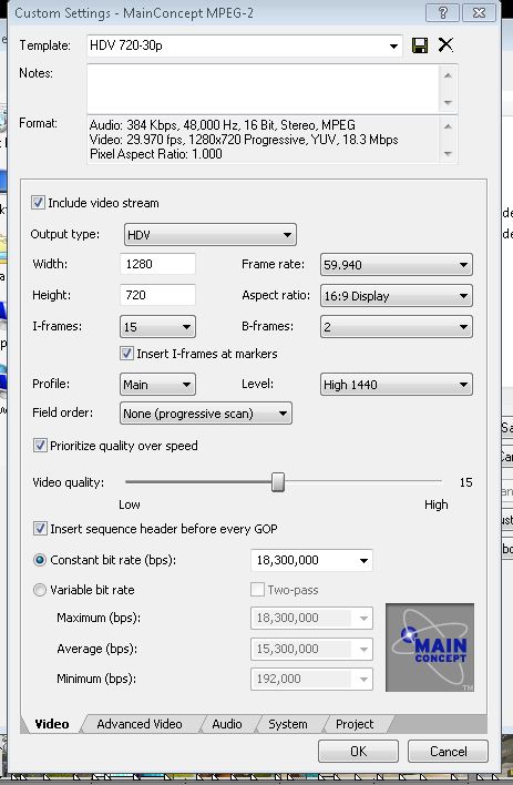

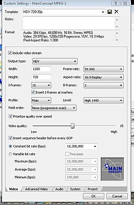

Ron, no joy in Cincinnati Our presets seem different. Mine 720 30p is progressive, but there is no 60p, only 30p, so I change the frame rate. Bit rate is by default around 18000, so that should be good.
Do you have a 720 60p preset?
I don't have a Blu-ray preset for 720, only a HD preset.

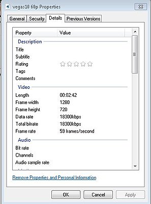

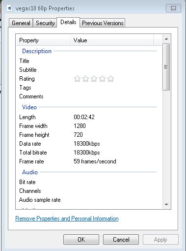

Same thing, my settings in DVDA are perfect, or at the least I'm sure they match my rendered footage:
Here is a screen shot of the clip properties
