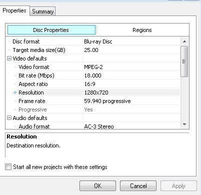

Yes, Ron, you have it. I have 720 60p footage on timeline (with some photos mixed in) and project properties are set to match the video, I don't even set the project properties manually, I let Vegas see the footage and choose the correct properties, and the frame rate is seen as 59.940.
However there is no 720 60p template in Vegas, so I choose the 720 30p template and change the frame rate to 59.940, which is as listed in my project properties, and set it to that in DVDA, 1280x720 of course.
I have also chosen (just now) for the first time a few minutes ago, 60 fps in Vegas and rendered to that, but it makes no difference.
I have included screen shots. It you need more information or if Ihaven't told you enough, please tell me.
the disc I just made where it didn't recompress doesn't play, so something was wrong there anyway.
DVDA wants to recompress HD video-render-setting.jpg   DVDA wants to recompress HD video-dvdasetting.jpg

First, I was under the impression bluray is always interlaced, so no matter what you are in, if it is progressive it will surely rerender it.
I am not sure I understand what you are actually wanting to do here.
