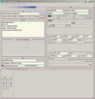

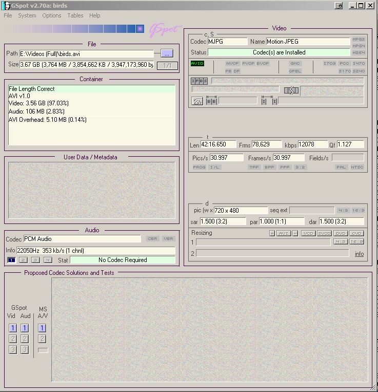

Here is the Gspot, Do I need to run the other?

It says it's Motion JPEG and Vegas Pro 10.0d should be able to handle MJPEG fine. Did the camera come with a disc that you installed previously but not on this new install? You obviously had the necessary codec installed previously.
