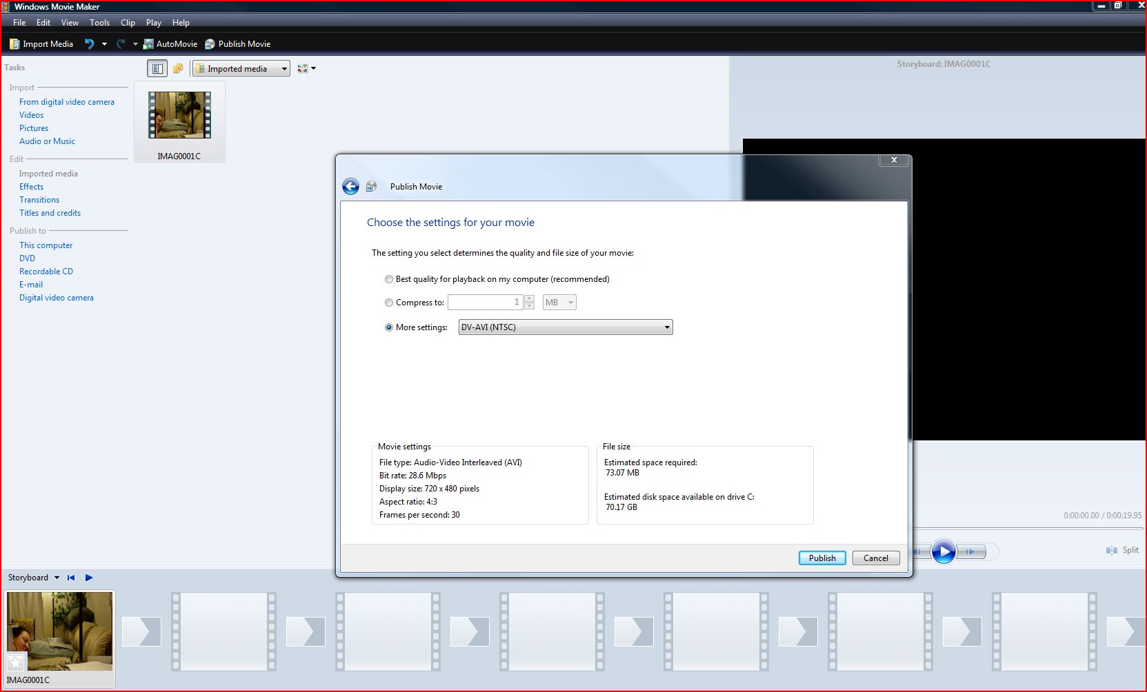

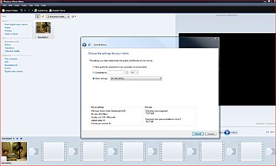

Old July 6th, 2011, 10:01 AM   #27
Location: Fredericksburg, VA
Posts: 282
Re: Can Hear But Not See an .avi File.
I can't do "seasoned," lol, but...
I see your clip is 720x480, so using Windows Movie maker, bundled with Vista:
import clip into Movie Maker
drag the clip to its timeline
"publish to computer"
choose "More settings"
DV-AVI, 720x480,
or
WMV DVD Quality
or
etc, from drop down menu options
Allow to render
open new file in Vegas
enjoy
Ponder again why $700 Vegas doesn't do this
move on
