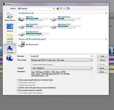

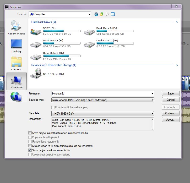

Just tried this in 64bit Vegas 10
90min of capture in 3 clips from a Canon HV20
Just wanted to make one file for easier syncing.
Flying along right now at 9%, black screen, No re-compression required.
Just chose the first template and changed to 25fps to match my footage.
All good.
