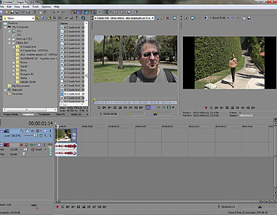

So I need a help to this issue: In a project with Sony MXF 1920X1080 23,97p clips and Cineform`s Neo 1440X1080 23,97p (converted from HDV) clips in a 1920X1080 23,97p project, the MXF clips play fine, but the Cineform clips are distorted, probably because an aspect ratio problem. With Vegas 9.e and 10, this bug doesn`t show up (despite with Vegas Pro 10 the project tend to crash when I try to work with it).
When I disable "mantain aspect ratio" in Properties of a Cineform`s Neo clip, it becomes correct.
Vegas simply shouldn`t behave like this and I can`t disable "mantain aspect ratio" of more than 500 Neo clips of my project to render it.
I attached a screen displaying in the source window a MXF frame and a Cineform frame in the timeline window.
Anyone can help?

It is most likely a pixel aspect ratio problem. Check the clips -- is the PAR 1.000? It needs to be 1.333.
This is an AVI issue which has been problematic in Vegas.

With the exception of DV widescreen files, there has never been a provision in the header of an AVI file to store aspect ratio information. MXF, AVC, and MPEG2 files do store this information. Vegas assumes that NTSC 720x480 AVI files are .9091 and 1920x1080 or 1280x720 have a PAR of 1.0. If it's a 720x480 widescreen AVI file (that isn't in the DV format) then you will have to manually tell it that the file has a PAR of 1.2121. Perhaps Vegas should assume that 1440x1080 AVI files have a PAR of 1.333.
