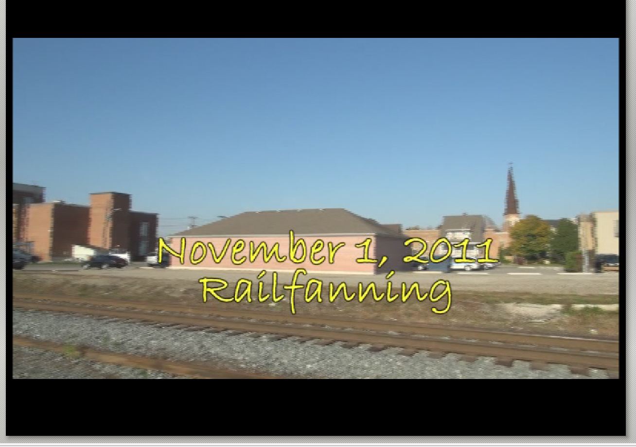

I do have a feeling that compression/recompression has something to do with my issues. I just don't know enough yet to set the proper settings. The default templates look much worse than any renders I have done from mini-dv footage. But, am I right to assume that shooting HD footage and authoring to DVD should give me a better picture than shooting in SD and authoring to DVD? Otherwise, why do people even bother to shoot HD unless they are all authoring to Blu_ray'?
I have noticed that my static shots look decent, but as soon as their is a camera pan or moving object, it looks brutal. Could that be a hint to the problem? ie. compression, interlacing, etc?
I have attached a screen grab of what a pan looks like on a finished render. Lots of jagged lines, jittery picture.
Again, thanks everyone for your suggestions. Keep them coming!

When rendering to MPG2 Vegas Render As defaults to 8, 6, and 192,000. Set the low number to 2,000,000, leave the top number at 8,000,000 and work with the middle or Average number to fit the amount of time the video project fills on the timeline. those numbers will work for project length upto 70 minutes. If you don't set the rates correctly IE too high for the size of the project DVDA will recompress the video and since it's already be done once when it get recompressed it will look pretty bad.
Edwards newletter of June 2003 Vol 1 No. 7 has a bitrate chart on page 2. It's my bible for setting bitrates.
Give that a try and see how it works but you need to start with a clean project, IOW nothing that has been compressed. Start with the VEG file then render away and see how it comes out in DVDA.
Don

Seth, excellent point, and good catch. Eric, what Seth points out is entirely correct. If you are rendering your files and they are non-DVDA compliant, DVDA will recompress them, often not to well.

What software are you playing that back in? It looks like it isn't being deinterlaced hence you see combing, so there may not be a problem at all with the encoding, just with whatever is playing it back.
Have you tried playing it back on a DVD player to a TV to see what it looks like?
Going from 1080i to SD will not necessarily give you a better picture than starting out in SD would, this is because resizing 1080i to interlaced SD is only giving you an approximation of interlaced SD.

Hi Phil,
I played back the finished product on a regular dvd player and a BluRay player. Video looked badly on both. Especially pans.
What could have I done in rendering to cause the combing?

I burned a few dvd's today and they do look much better than the day I started this thread. The bit-rate changes going to variable really helped. Also in the render as dialog box I choose lower field first. In the project dialog box I went with lower field first, and interpolate. I am still not quite sure what all of the settings mean but I am making some progress. I can't wait to start authoring to BluRay to take advantage of the AVCHD picture quality.
