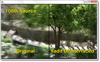

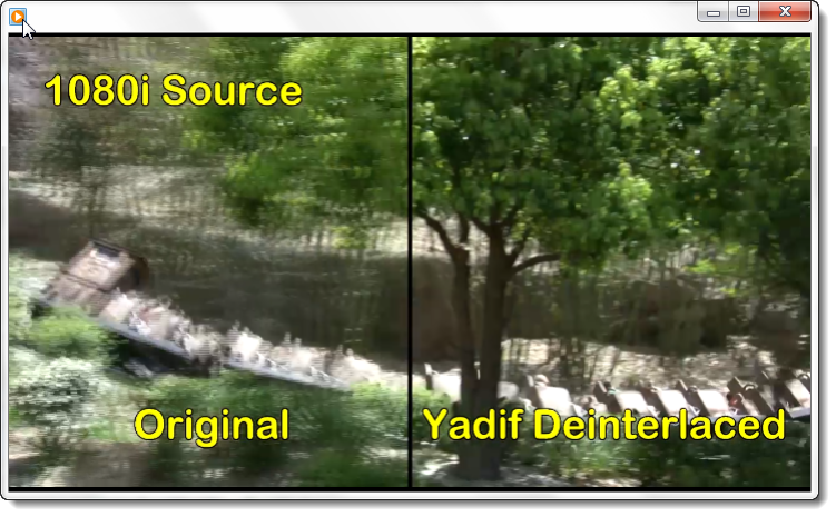

Assuming you plan to deliver your renders to the web (i.e. YouTube, Vimeo, etc.). Here's what I'd do. There may be better ways, but here's the test I just ran seems to work pretty well.
1) Create a Vegas Project using the "Match Media Settings" wizard to match the 720p source.
2) Add a 720p source clip to the timeline.
3) Add a 1080i souce clip to the timeline.
4) Add the yohng.com Yadif Deinterlace for Sony Vegas deinterlace FX as a Media FX
5) Render the project to the MainConcept "Internet HD 720p" template.
The video is here: Mixed720p1080i.mp4 - YouTube
However, the telling result is in the attached image.
...Jerry
Jerry Amende is offline   Reply With Quote
