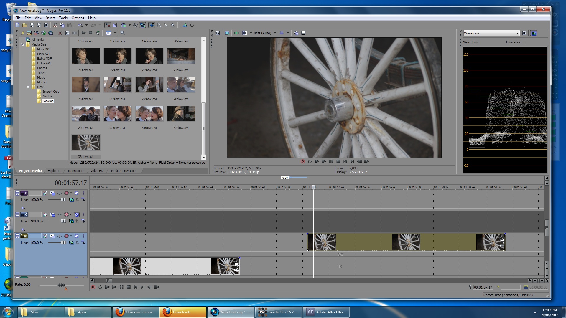

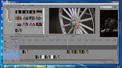

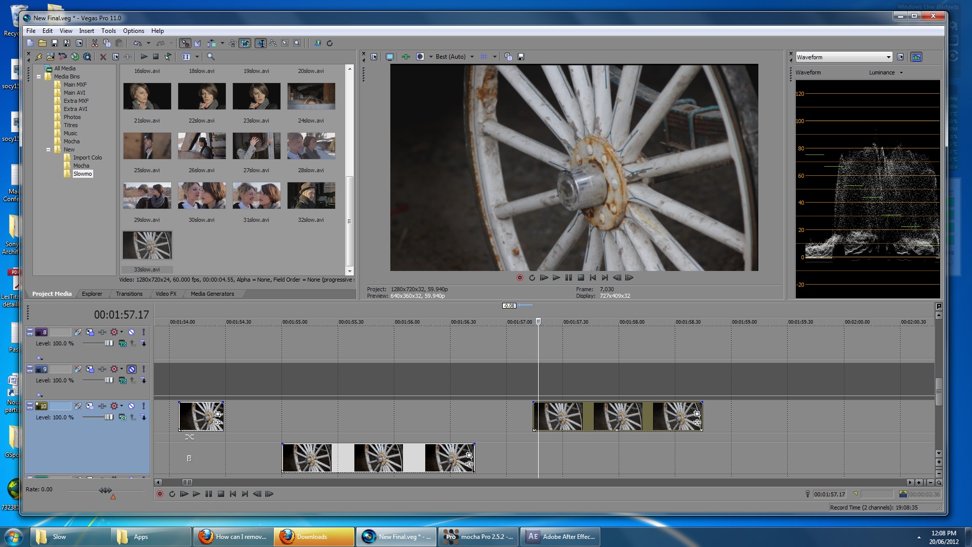

Please take a look at the screenshots attached. The "No scrub" is for when I am doing nothing, notice the waveform.
The "Scrub" is when I am scrubbing (shortening) the clip, now see the waveform and the contrast in the shot!
I had all those clips color graded, because of a LONG story my grader rendered everything in QT Animation. Back to my place I imported all clips and now I have to redo the slowmotion. I do mine by frameserving in VirtualDub through an AVS script.
When I do that I reencode in a lossless format, Huffyuv and reimport in Vegas.
So the clip I am scrubbing in the screenshot has gone through this process. I have tried with another lossless codec, Lagarith, which yielded the same results.
Two things
-If I scrub the original QT Animation It also reveals a different contrast, one which has super blacks
-If I were to redo the slomo process the resulted clip would lose another 10-15% contrast. Scrubbing through it would reveal the "second" original contrast level.
Why is this happening?
Scrubbing a clip reveals a different contrast-scrub.jpg   Scrubbing a clip reveals a different contrast-no-scrub.jpg

I don't have a direct answer for your question, but in this situation I would try some sample renders to whatever your destination format will be. Do these setup and gamma variations show in renders in any way?
This would, in turn, help me to understand how seriously this might impact my product, and how much time to spend on further analysis.
It sure looks like some 0-254 vs. 16-236 B.S.

Well kinda of an update.
It occurred to me that the "scrubbing" effect is the same as when there are effects applied in a clip. When I scrubbed an FX'd clip the preview window will show the original video.
So now my cursor is on a clip and when I press the "split screen view", set to FX Bypassed, I see this gain in contrast, just like the scrubbing effect described earlier. Before I activate this function my black show to be on 16 and when I deactivate it they are at 0
Now I do not have any FX on that clip so what could explain this behavior?
