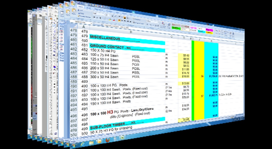

Hmmm...followed your instructions Ian and ended up with only the bottom image showing as per screen shot below:
All the other ones appear to be there but are transparent (?) except for the tops and right hand ends. Shadows are there also...sort of...

Re: no drop shadow option
You're not going to get much shadow showing against a black background ;-)
Having said that you can see the shadow on the layers below so it looks like you've set it up correctly.
As for the transparent issue - not sure what you mean by that. I can't see any transparency in the screenshot you posted, and surely all you would expect to see in a stack of images would be just the edges of the images below?
Can you give some more detail as to what it is that's not working how you'd expect it to?

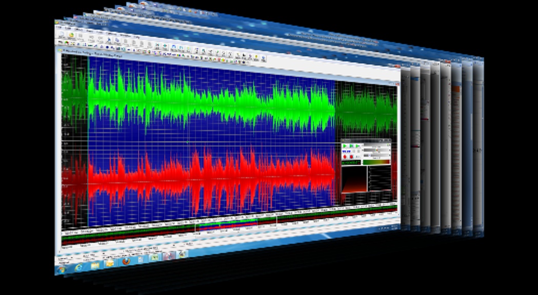

The curser is at a place where the top image should be showing and only the left hand edge of all the other ones. Then when the transition occurs the image is slid out of the eay to the right exposing the second in the stack...and so on down to the bottom one - the one in the image already posted.
I've just undone all the parent child stuff and here is what it should look like at the start before any of them are slid away...only I don't have shadows...I'm wanting the shadows on the lower images, not on the background :-)

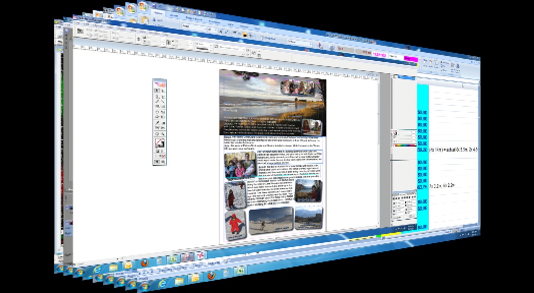

As soon as I insert a new video track in the stack of tracks with images on, I wipe out all tracks below the new track. The way I have the various tracks stacked up as seen in the sg in comment above, eack track has its image reduced in size relative to the one above it to produce the stack effect. By inserting a blank video track say in the middle of the stack, all images above that are wiped out for the area of the image around that level in the stack. Thus because the higher images are larger than the lower ones, some area of the higher images show. It's a bit hard to see because all the SG look similar around the edges, but in the image below you can see part of the very top image (a spread sheet image) at the right.
Can you post a screengrab of your Vegas workspace? Not sure I am going to be able to hep much for a while as I'm off on a week long job, but someone else might spot something.
