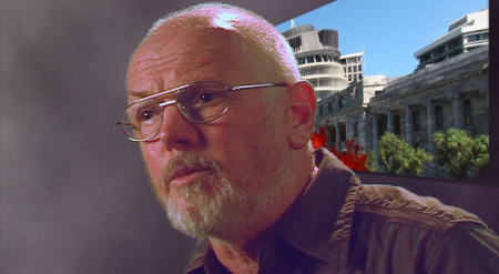

Apparently as soon as you click '3D source' from the drop down menu at the top left of the 'track motion' window, the drop shadow/glow options of the 2D window disappear. I'm not aware if they can be got back or not - presume not...
For the shadow I put a black event of the same length under the picture, first of all using exactly the same numbers used for the picture in the track motion window, then moved it to where I wanted it as a shadow. I also used a composite envelope to reduce opacity of the 'shadow' by about 50% or so...
I also wanted to round the corners of the picture and shadow...so...I went on the web and found a short tutorial -
- which gave me the basic idea of how to do this...through 'Video Event fx >Soft contrast'. I did this to both the picture and the shadow events...fiddling with the parameters till I had what I wanted. Screen shot below...It's fairly subtle but there...
