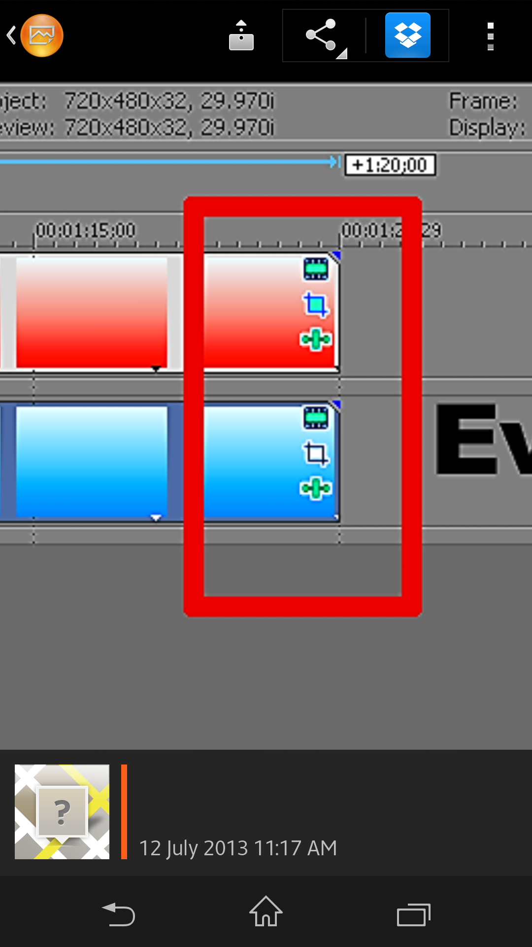

Old July 11th, 2013, 07:26 PM   #9
Join Date: Oct 2009
Location: Central Coast Australia
Posts: 1,050
Re: track motion on/off?
Looks like a green cross to me
track motion on/off?-screenshot_2013-07-12-11-18-57.png
http://vimeo.com/livewebvideo
Gerald Webb is offline   Reply With Quote
Old July 11th, 2013, 09:56 PM   #10
Join Date: Jul 2007
Location: New Zealand
Posts: 1,180
Nah..that's not a cross. Actually I don't know what it is but know it aen't a cross. A cross is like the 'red cross' in the top right hand corner of the Pan/Crop or Track Motion window...
However, I didn't know about that right click menu... :-)
Renton Maclachlan is offline   Reply With Quote
