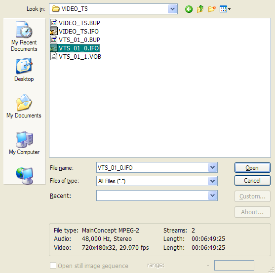

Here's a very useful tip that I discovered some time ago, Hope it helps.
Vegas allows you to open up a DVD .IFO file. This imports the entire .VOB chain for both video and audio tracks.
Click File / Open, then navigate to your VIDEO_TS sub directory and enter *.IFO in the File name input field. For a regular DVD you will see a VIDEO_TS.IFO, and a VTS_01_0.IFO. Select the VTS_01_0.IFO file and click on Open.
Don't try this on a DVD disk because Vegas will try to build an .sfk file containing audio peaks in the VIDEO_TS directory.

Sorry about that Norris. I should edit my original post to clarify things.
When you browse to the VIDEO_TS folder using "Import Media", it will appear to be empty until you select "All Files (*.*) in the import box. Once you do that, all the files will be visible. Select the appropriate one, import it and drag it to your timeline.
