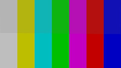

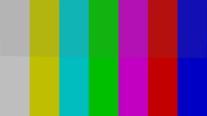

Tim, actualy you twice resize vertical size - 1080p to 405p and 405p to 480i or 480p.
And you don't use correct color space transformation from 709 to 601 what causes some color shift in DVD.
