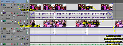

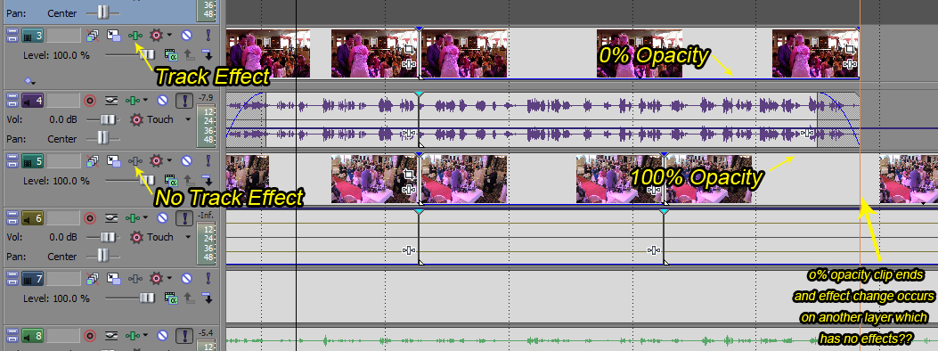

Definitely the hardest topic I've ever tried to create a title for. Here is the issue in full! Looking at the images will make my issue much clearer.
A track with a track effect applied has a 0% opacity clip. The track below (visible through the 0% opacity) has no effects applied. However - when the 0% clip above ends I see a change in the colours on the other visible track.
Can anyone explain to me why another track is being affected at all and how to fix it. No doubt you will ask why I have 0% opacity. Well its just how I do my workflow on multicam edits. I find its easier to change around things later. Perhaps you will tell me 'It just doesn't work like that!'. Which might be what i need to hear.
Please help! Do I need to go through my hour long timeline and delete my 0% opacity sections?

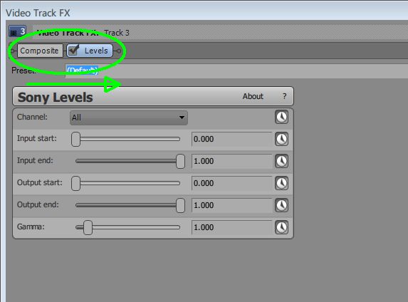

My only guess is that you have applied the track fx as an adjustment layer, being that it is added after the composite tab (see pic).
Moving it before should fix this issue.... if thats what it is....

Had a look Gerald, and i can see the difference having the effects before and after composite - but that's not solving my issue.
Basically I conclude that the opacity doesn't reduce the effects - only the clip itself - the effects still remain and seem to 'fall' onto whatever the next visible track is.
