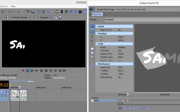

Trying find a way to create the effect of someone signing their name. Ideally I would like to be able to capture the person's real signature perhaps on a tablet or something. Alternatively I have a handwriting font. I just don't know how make it appear as if someone is signing their name. Here is an example in the opening of this clip.

A good technique is the use of the mask with keyframes:

Thanks Juan - I will give that a try!
