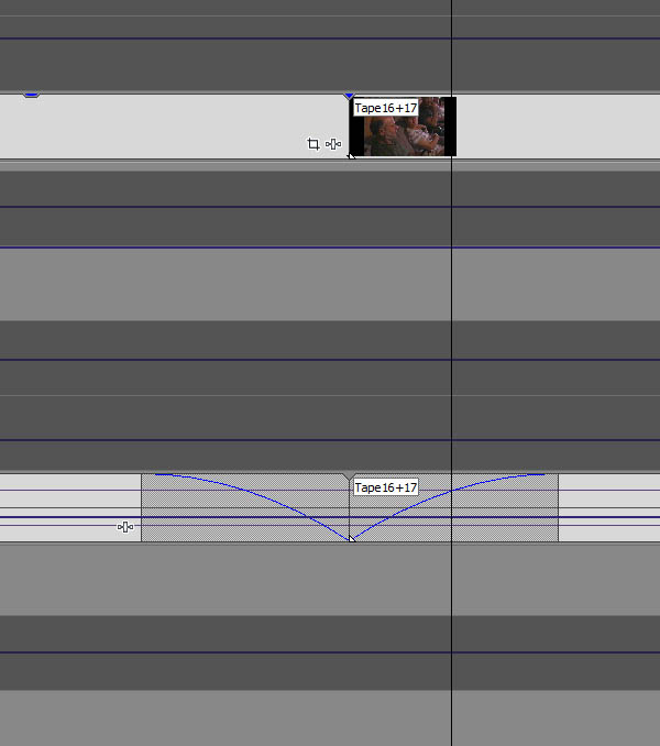

This is two clips butted up against each other. The audio always gets automatically faded-in and faded-out. Which I need to remove one by one at the end before my final render of a project (or the audio stutters).

Actually, you want that to happen. If it doesn't, you might get a slight popping noise. You can define the length in the preferences. Default is 10ns. And, yes, you can turn it off - Options - QuickFade Audio Edits

In addition, if you're doing a project where you already know you want an audio fade at almost every spot you make a cut, you can set the value to 1000 milliseconds and get an automatic 1 second fade instead of putting one in manually every time.
I recently did this with several audio-only projects where the material was being cut down and rendered to dozens and dozens of individual files and it was very helpful.
