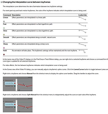

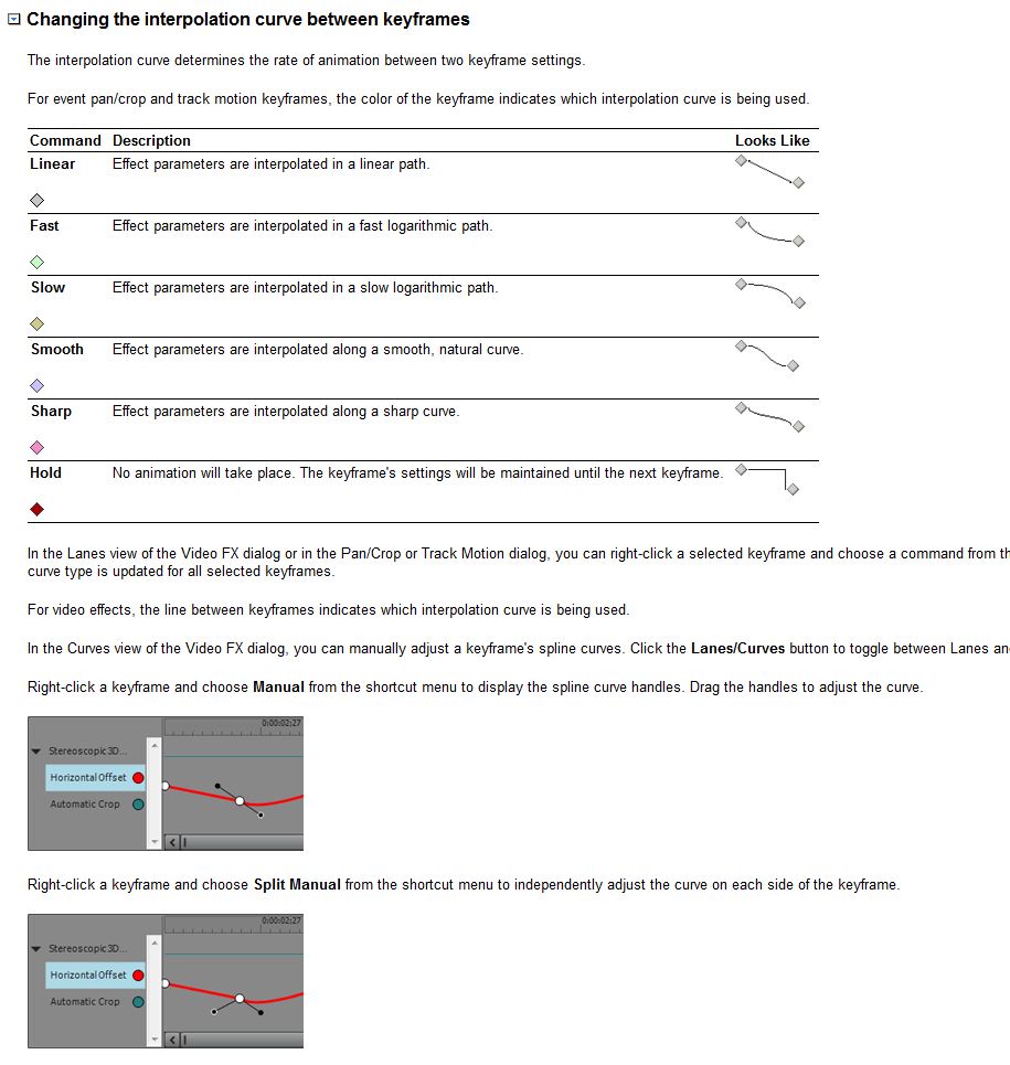

Old December 9th, 2015, 07:12 PM   #8
Location: Sydney Australia
Posts: 1,622
Re: Smoothing out keyframe transition effects
Originally Posted by Renton Maclachlan View Post
...that there is a curve from say keyframe 1 to keyframe 2 which at keyframe 2 is determined by a/the curve from keyframe 2 to keyframe 3...and visa versa.
You are on the right track Renton. Play around with those right click options and you will get different results. Just be careful of frame edges as some of those options will impart a curved trajectory between points and if you are making moves with nearly full frame crops you will sometimes find that the move will push our past the edge of your frame and then back in again. We call it the Sony S bend.
See the graphic below. This can all be found under Keyframe Animation under the Vegas Help file dialogue.
Chris Young
CYV Productions
Sydney
Last edited by Christopher Young; December 9th, 2015 at 07:24 PM. Reason: Insert graphic
