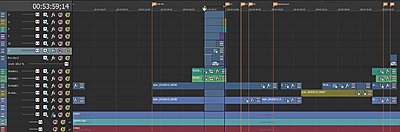

I'll have to pick through your thoughts to see what I can glean from them. Tough to convey a process in words, or perhaps just tougher for me to envision it.
I'm craving a better workflow, and I think that more segmenting and nesting may be the direction that I need to go, instead of flowing left to right and running with it.
As an example, I'm fussing with a glitch within the selected portion, and I can selectively pre-render in place and move on. But if shifts happen it's lost.
I wish that I could render to a new track and simply tag it as the default piece to use (like a selectively pre-rendered piece is by default) without having to remove everything under it by splitting, moving or deleting, and needing to make sure that any moved/deleted trak motion points that went too get reestablished for the remaining elements after it. It'd be nice to render to a new trak, tag it to use by default, leave it on a higher level, and move on.
Or, make selectively pre-rendered segments able to shift with their associated elements instead of disappearing. I understand that they're invalid if content changes within their parameters, but location alone killing them is a shame.

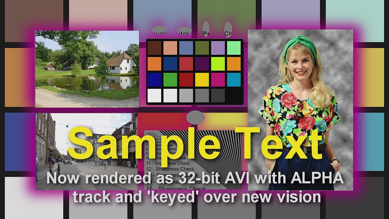

Sam they will render with solid black backgrounds unless you use any 32 bit codec that supports Alpha channels to render them out. Your composite track needs to be rendered out over a clear background. In other words an empty or muted lower track. A 32-bit rendered video supports an ALPHA channel.
Now when you have rendered out your video with its Alpha channel you place it on an upper, or the topmost track then right click on it select 'Properties' and then activate its Alpha channel by selecting 'Premultiplied.' This activates the Alpha channel for transparency. Now your lower layer video tracks will become visible through the keyed new 32-bit Alpha overlay tack rendered elements.
I do this all the time with company logos, graphics I've made or video or any other element that needs a transparent background or cutouts to allow underlying video to show through. Just be prepared for those 32-bit Alpha renders to be biggish files. This is how we always used to key in linear tape to tape video edit suites for years. These days this is how you do it, or one of the ways you do it in an NLE.

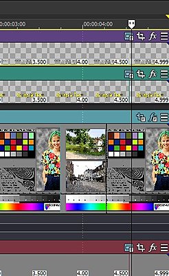

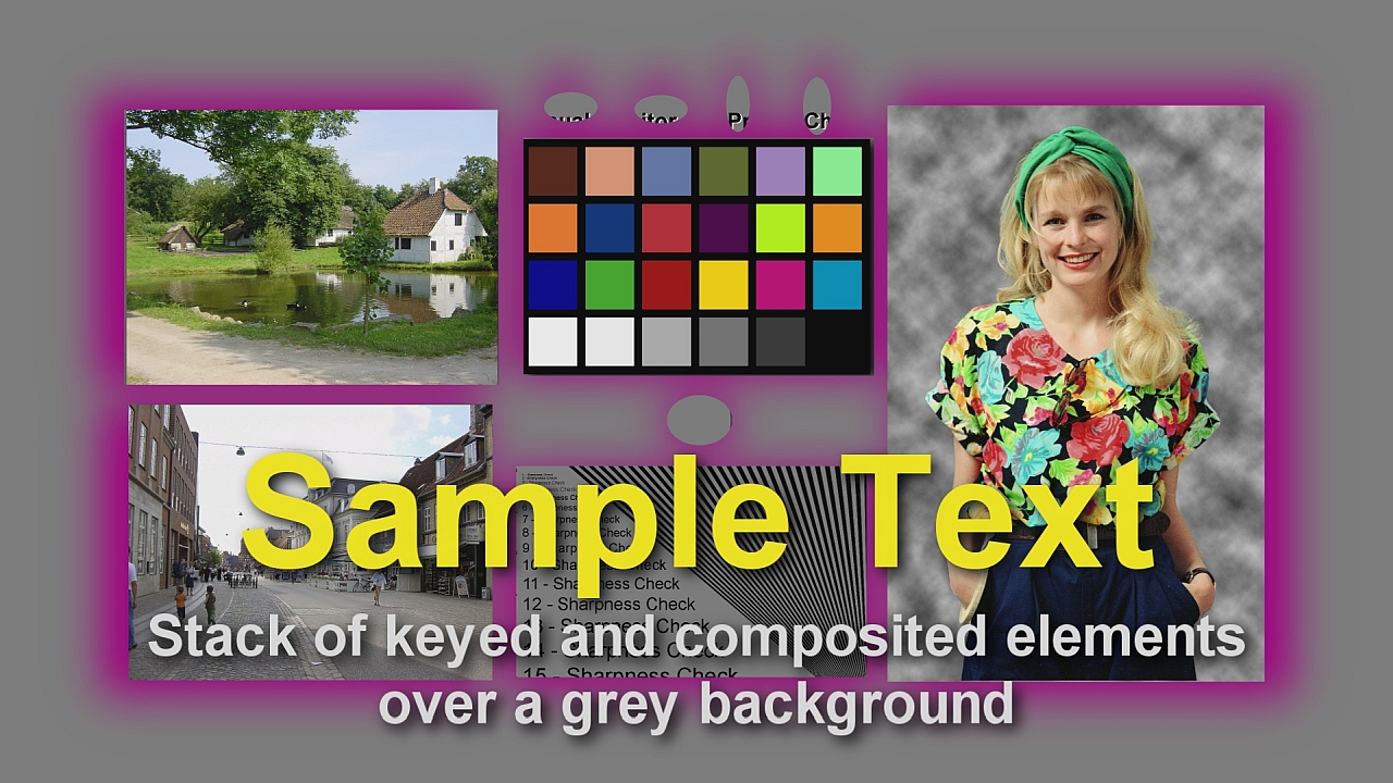

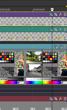

The first image is a Vegas composite of an image with masked areas and a track motion glow plus some generated media.
The track view image is how the stacked tracks looked. I compiled them over grey so I can see what I'm doing. IMPORTANT, you must mute this grey or whatever color track you chose to use while compiling your composite before you render your 32-bit Alpha channel AVI.
The last image is actually the composite 32-bit video with activated Alpha channel over a new image. Of course with this new Alpha rendered video being a total composite of its elements you can now grade, fly, flip, zoom or move it it one element as you would with any other piece of video.
Chris Young
pre-render feature wish-masked-track-motion-glow-over-grey.jpg   pre-render feature wish-fig-look-like-.jpg
