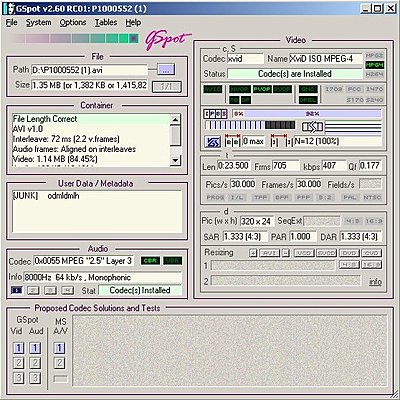

I would be inclined to download GSpot to analyze the clips to find out exactly what codecs are involved and if they are already available on your computer. Most likely the codecs are not installed if you can't play the clips. If they are missing at least you will know which ones they are and can then take steps to installing them to sort the issue.
https://www.videohelp.com/software/GSpot
Chris Young
