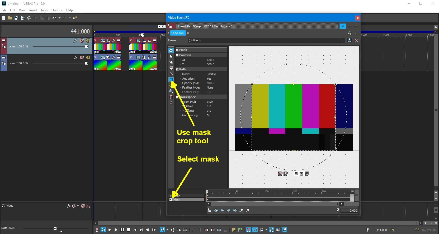

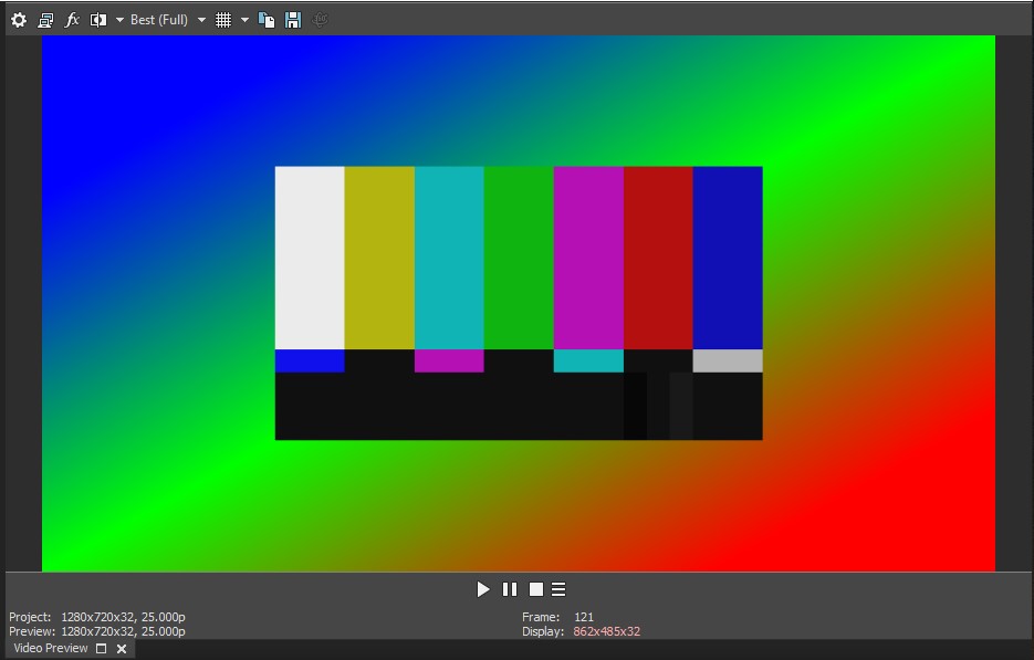

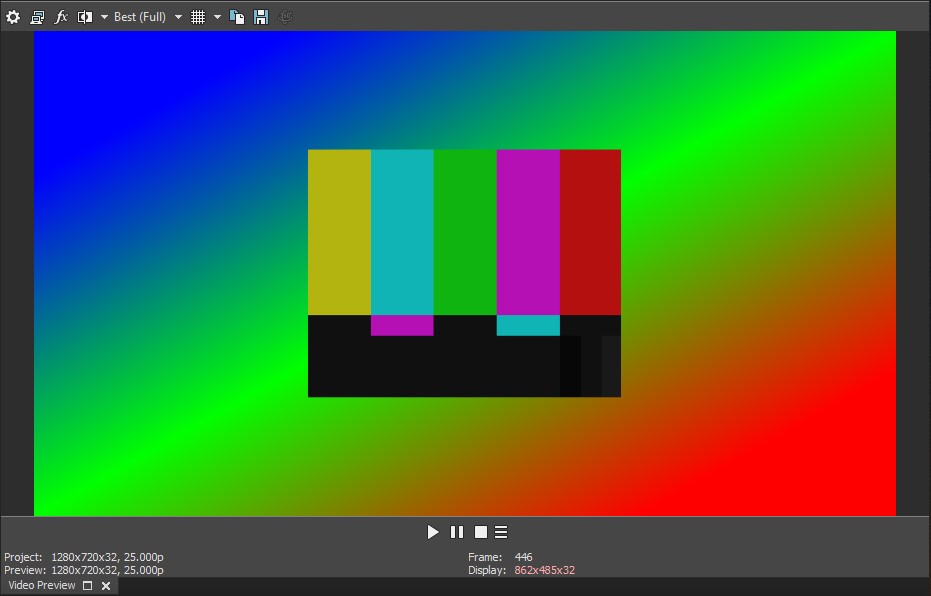

I think doing the following is probably the simplest solution. Place your top track Pan & Crop image where you require it to be. Now open up the P&C window for that clip and go down in the P&C window and check the box marked "Mask." Now use the square mask tool to select just the section of the image section you require. In the example below I have an image #1, color bars P&C'd over a color grad. In image #2 it is exactly the same thing but with the White and Blue bars masked out.
