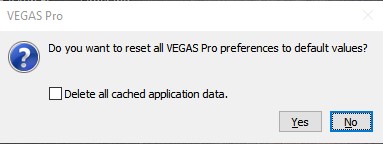

Before starting Vegas 17 Hold down both the CTRL and SHIFT keys. Now double-click on your Vegas 17 icon to start Vegas. You should get the following image pop up. Tick the "Delete all cached application data." check box. Select YES to totally reinitialize Vegas. Hopefully, this will fix the problem.
"WARNING" Take note! This will reset everything back to the initial Vegas install parameters. If you have created render presets etc along with saved GUI layouts all those will be lost. You will have to recreate them. You have nothing to lose really so it may be a way to fix the problem. Good luck.

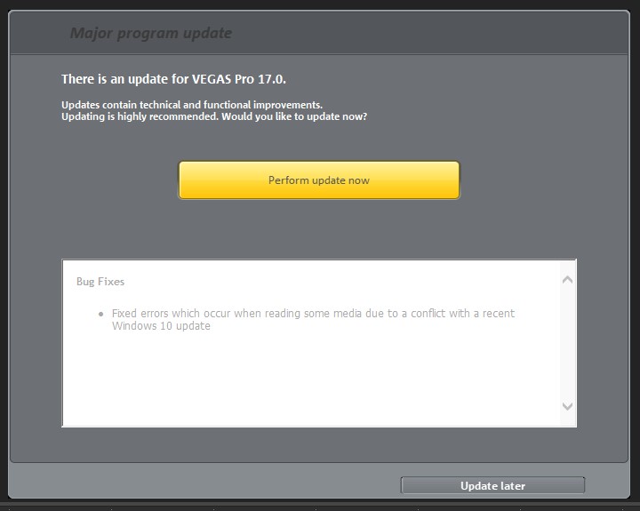

Just received the following v17 upgrade to build 455. It states it fixes a conflict with recent Windows 10 updates. Let's see if it solves the problem!

This has been fixed in the current installer of Vegas Pro 18. Plus you can log into your account at Magix and download the installer from there and install it directly without needing to have VEGAS open.

Yes, they really fixed the issue in the last Vegas Pro 18 update. Of course, that only fixed it AFTER it is updated so going to your account and downloading it from there or going to "News" forum post telling about this update in at vegascreativesoftware will get you the new download link.
