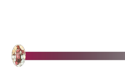

I would certainly guess that track 2 has Track Motion applied as the original logo on the timeline before that was probably "shrunk" to fit in that corner. Either some keyframes would need to be added to reset the Track Motion for full size or the greenscreen image would need to be on a different track.
I also have many full screen PNG files that we just add to a track. They are full frame size so no resizing needs to be done and everything is transparent except for the part that needs to show. Attached is an example of one. Then I put a text media generator on the track above it to add a title in the red shaded area. Everything is totally transparent except the image on the left and the red bar - and the red bar even becomes more transparent the farther to the right it goes.
I am having a problem inserting a photo into the video timeline-slider-stained-glassws.png

yes, if it's an overlay you use repeatedly, then doing it the way you describe is ideal as it simplifies your workflow.
Roberto Diaz is offline   Reply With Quote
