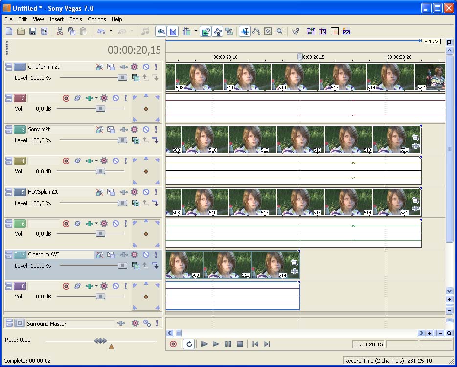

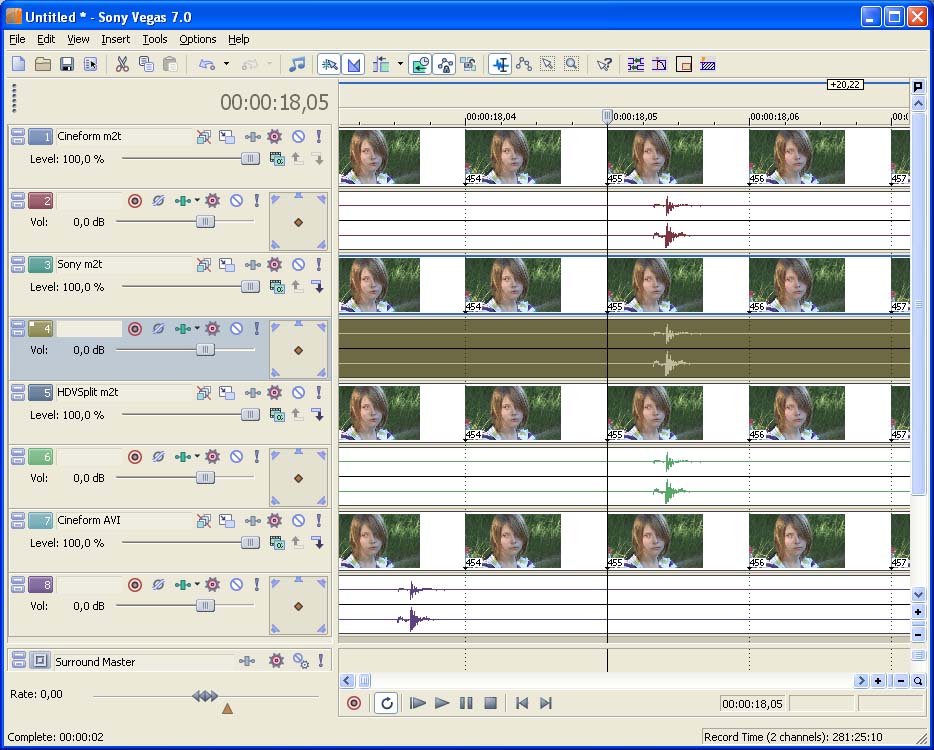

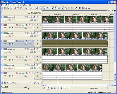

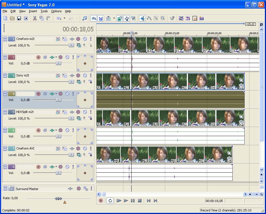

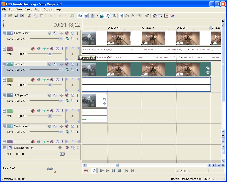

this is indeed something that has been discussed here in the past. I myself and Christian here did swap some emails concerning the issue a while ago.

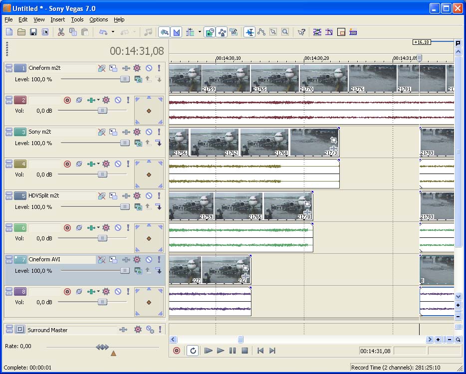

I did some testing with different capture apps and methods. The pictures below are actual snapshots from Vegas 7c timeline. The Video tracks are named (Audio follows the video):
- Cineform m2t -> uninterrupted m2t-stream captured with HDLink/ConnectHD
- Sony m2t -> m2t-stream captured with Vegas VidCap; scene detection on
- HDVSplit m2t -> m2t-stream captured with HDVSplit; scene detection on
- Cineform AVI -> captured with HDLink/ConnectHD; scene detection on; converted to CFHD on the fly
And the images should contain following:
VegasHDV_1.jpg shows how the audioin CFHD is lagging approx. 1.5 frames when compared to m2t-streams (regardless of capture app)
VegasHDV_2.jpg:same thing but zoomed so that you can see the frame numbers. Also if you play all audio tracks simultaneously, you can hear the echo, which will go away if you mute the CFHD-audio stream. So the problem is not just related how Vegas shows the "audio graphics"
VegasHDV_3.jpg: Here you can see how material captured and splitted by HDLink is shorter than the two others (HDSplit & Vegas). So it handles scene detection differently. Sony VidCap is bleeding to another scene...
VegasHDV_4.jpg: Here you can see the muting of the sound just before clip ends. As you can see from the upmost track the audio continues without any change in volume. HDVSplit seems to be a tad better than Sony VidCap. Clips start from the same position.
VegasHDV_5.jpg: And here's the last evidence: Sony VidCap "bleeds" to next scene altogether. HDLink has so big "safe margin" that it is not shown at all.

Gaps between .m2t files-vegashdv_1.jpg   Gaps between .m2t files-vegashdv_2.jpg
Gaps between .m2t files-vegashdv_3.jpg   Gaps between .m2t files-vegashdv_4.jpg
Matti Remonen is offline   Reply With Quote
